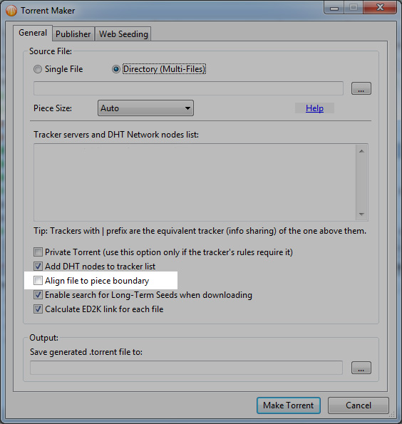

T_Azam Posted July 7, 2011 Author Share Posted July 7, 2011 Further research on this led me to an option in the make torrent dialogue box. The " align file to piece boundary ". I've learned that this option, enabled by default from version .85 creates the padding files and disabling it will stop the creation of the said files in the torrent. But what I've learned about the reason behind it's creation now, my question to you is, will this option if disabled at the time of making the torrent create any kind of problem, such as 1) Downloaded torrent not opening 2) Downloaded torrent not playing 3) Downloaded torrent stuck at 99.99% I've given the site address on this topic below for the benefit of forum users. http://wiki.bitcomet.com/align_file_to_piece_boundary Thanks & T.C. Link to comment Share on other sites More sharing options...
The UnUsual Suspect Posted July 7, 2011 Share Posted July 7, 2011 This option can easily be disabled by unticking the "align file boundry" option when making a torrent. As far as someone banning torrents that contain padding files, this is done either out of ignorance, or stupidity. Ignorance can be cured, so I will attempt to do so in the case that a reader may wish to know the reasons for these files. When bittorrent downloading occurs, it doesn't download a group of files, it downloads a group of pieces, some pieces can contain data belonging to two or more files. The use of padding files simplifies this so that bittorrent protocol becomes more compatible with http/ftp and emule downloading, so you can more efficiently download the pieces from sources outside the bittorrent swarm. Q: Someone might make the comment that these padding files may benefit the bitcomet user, but the rest of the users don't benefit and have these annoying files they have to download. A: These files can indeed benefit the entire swarm in some situations. If this torrent was unseeded and the entire swarm was stuck with less then 100%, a bitcomet peer could complete the download from sources outside the bittorrent swarm, then in turn become a seeder and revive a dead torrent. Also, these files are very small and are harmless. There is no rational argument for calling them annoying and after your finished seeding the task, the user can simply delete them. Q: Can a non-bitcomet peer simply disable the download of these files? A: Yes, but doing so won't stop them from being downloaded, they just won't appear in your GUI. Your bittorrent client will put them in a temp file containing unwanted data that are normally created when individual files are disabled in a torrent. The uTorrent client will put them in a file such as "~uTorrentPartFile_xxxxxxxxx.dat", and other clients have a similar method, but if other clients adopted bitcomet's method, it would serve everyone's interest. Link to comment Share on other sites More sharing options...
The UnUsual Suspect Posted July 7, 2011 Share Posted July 7, 2011 ps. to answer your questions from your second post. Disabling this option won't cause any problems for a normal bittorrent download in any way. However, lets assume you have a torrent containing 3 movies and the swarm is all stuck at 90% and movies 1 and 2 are complete, and movie three is incomplete. If BitComet finds this same file on emule (or other) network and downloads it, your torrent will be 100% complete IF it contained padding files. If it did not, then the torrent may only be able to use 99.9% of the complete movie 3 that was downloaded from emule. You'll have the complete movie, but you won't have 100% of the bittorrent pieces so you can share it all with the swarm. The above situation could occur when movie 3 was accompanied with a text file or nfo, and although you downloaded the complete movie via emule sources, you could not share the complete movie because one or more of the bittorrent pieces would be incomplete. Padding files would negate the possibility of this happening. In this case, a tracker that banned padding files only harmed themselves. Link to comment Share on other sites More sharing options...
