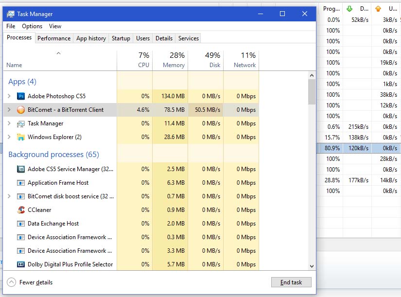

I decided to check the Task Manager when BitComet was lagging, and it showed anywhere between 30MB/s to 55MB/s of disk activity from BitComet:
/monthly_05_2016/post-184454-0-84693500-1463767426.jpg" rel=“”>
As you can see in the above image, my download and upload rates totaled less than 1MB/s at the time, so I’m not sure what all of the extra disk activity is for.

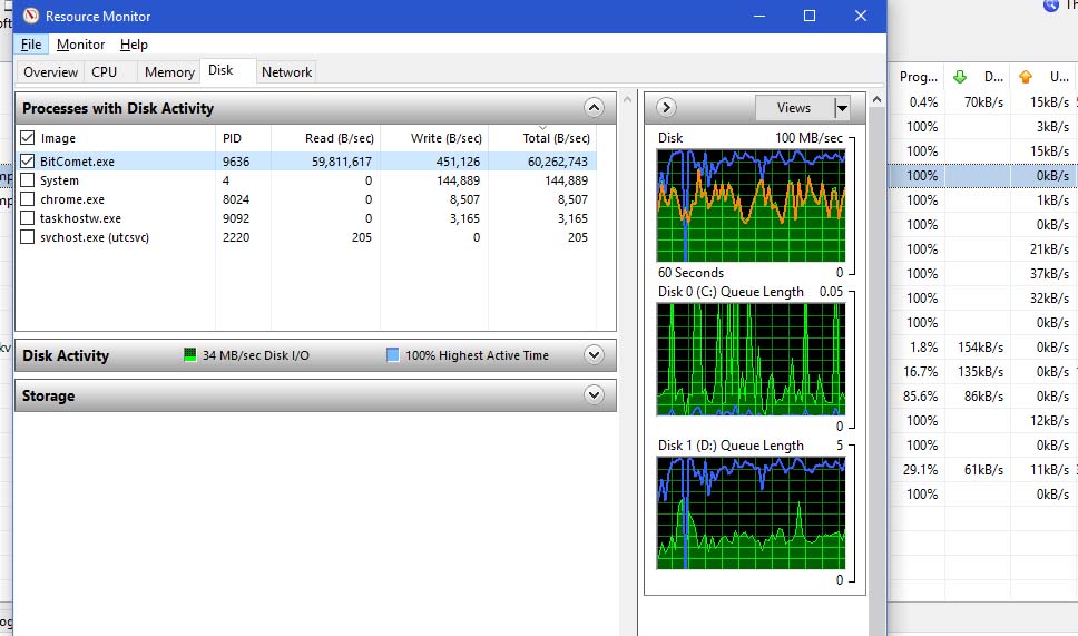

I opened the Resource Monitor in an attempt to figure out what BitComet was doing, and it would seem that BitComet is reading an unnecessary amount of data from my hard drive:
/monthly_05_2016/post-184454-0-60804600-1463768314.jpg" rel=“”>
I’m pretty sure this is a bug because it happens almost every time on Windows 10, but I’ve never had it happen on Windows 7. Maybe I’m stupid and it’s just a problem with my configuration, but I haven’t changed any of the BitComet options (other than changing the listen port for port forwarding), so I don’t think that’s the case.
Go to Tools > Options > Disk Cache and change the default settings to these ones:
Min disc cache 50
Max disc cache 1024
Shrink disc cache if free mem lower than 500
Cache size for HTTP 2048
These options will store cached data on RAM and prevent disk overload.
the recommended settings will vary depending on how much ram memory you have installed. The default is to assume you have a minimal amount of ram so disc cache size is very small. By increasing you prevent excessive use of harddrive, but will use more ram memory.
Ah, that seems to have fixed things! Thanks!
Sorry for the false alarm; I just got a new laptop and I’d never had these issues before on my previous (windows 7) one, so I assumed it was yet another “program not working properly on Windows 10” issue.
I assumed his laptop has a lot of memory since he is running Phhotoshop, BitComet + Windows’s servicies and only 28% of RAM are being used.
