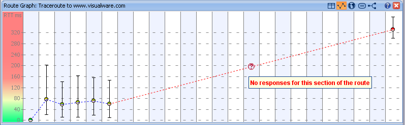

6)i download VirtualRoute to trace,
here is IP node in the result(see the picture below)
221.175.122.79 TTL 0
221.175.120.1 TTL 1
222.47.1.149 TTL 2
222.47.1.173 TTL 3
222.47.1.170 TTL 4
122.90.9.66 TTL 5
No response for this section of the route

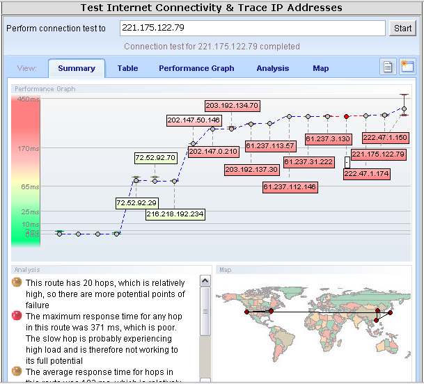

7)i use http://visualroute.visualware.com/ trace back to my IP.
i attach result picture below
there is loss hop too(red point with white box on the left side)

  1. tracert is new command for me,thank you.
  2. last reply i tract for both side
-from my IP to www.visualware.com in 6) (you can see first image write ‘Traceroute to www.visualware.com’)
-from www.visualware.com to my IP in 7) + second image

it show that http://visualroute.visualware.com/ can ping and route to my IP.
i am not perfectly behind gateway or firewall.
but GreatFirewall make other peer&BitComet server misunderstand and take GreatFirewall IP instead of my IP.
the consequence is every peer which try to connect to me try to connect to GreatFirewall instead of my computer.
so no one can connect to me via port 26523, that is the problem.

**update i am misunderstand,
the test from http://visualroute.visualware.com/
also have additional message which i ignored.
it said i am behind firewall(ping 100% loss)
so case closed**
