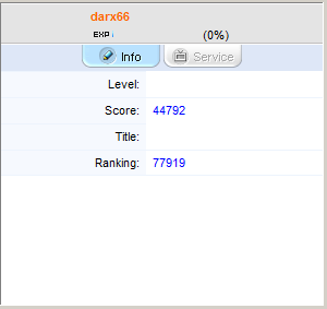

I do not think that my Comet ID is functioning normally. For the past week I have downloaded stuff and my EXP bar does not get any EXP. Could this be a bug? I have signed out and in many times and still there was no difference. Can someone help? I am stuck on my current level:
Level:
Score: 44691
Title:
Ranking:78191
As you see I cannot see my LEVEL & TILE in BitComet. I can access my Comet ID via Website then I see my current stats. Still my stats has not changed and i downloaded quite a bit.
Can you post a screenshot of the comet IP pane in bitcomet please.
Also tell us your comet ID name, if it’s not being shown in bitcomet.
Okay thank you for your time. I attached my Comet ID Pane and my Username to sign into Comet as shown is: darx66
/monthly_02_2011/post-61189-12978138815227.png" rel=“”>

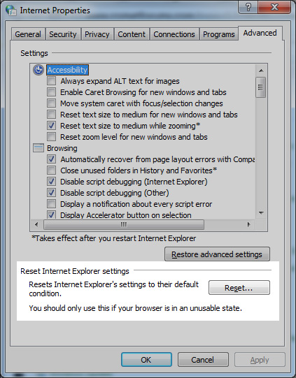

This error occurred because the script of BitComet could not be properly run, please check your IE settings, or restore default settings. :slight_smile:
Go to “control Panel” and “Internet Options” (see screenshot).
Note that the problem is most likely a setting or program that is blocking scripts from running. Resetting to default is the easiest solution, but isn’t required if you can figure out what setting is blocking the script. Unfortunately determining that would be exceedingly difficult of us to determine without direct access to your system.
/monthly_02_2011/post-1287-12983011108011.jpg" rel=“”>
