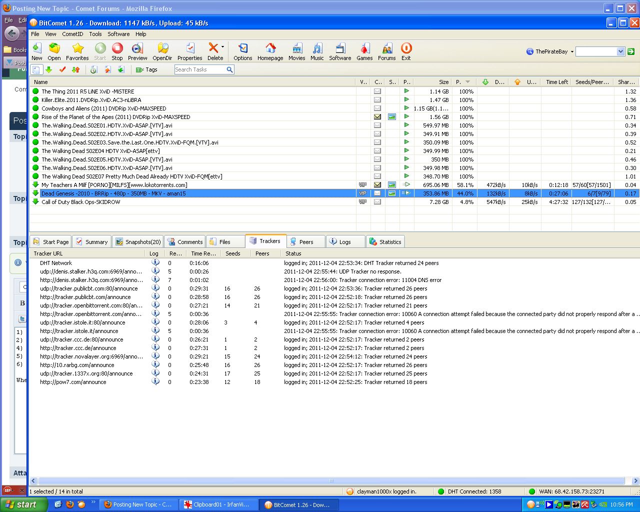

When I first start up BitComet (BC) I get real good DL speeds, pics 01 and 02.
/monthly_12_2011/post-24345-13230574862376.jpg" rel=“”>
/monthly_12_2011/post-24345-13230574935081.jpg" rel=“”>
However, after a few minutes of this everything drops to nothing, absolutely nothing even though the seeders remain high, I get zero DL numbers.
/monthly_12_2011/post-24345-13230580544076.jpg" rel=“”>
When this happens the little internet icon in my task bar also goes to yellow instead of green and my wireless icon states that I am getting 2.0Mbps instead of the usual 54.0Mbps. I guess what I am wondering is, Comcast must be throttling off my internet connection when BitComet is running, but how would they know this? After I get zero DLing and shut BC off, a few minutes later my internet gets back up to full speed again and I can restart BC and get full speeds again, but again only for a limited time.
Isn’t 1147kBs=1.147mbps, that is not a whole lot is it? Why would Comcast throttle that back or are they detecting p2p sharing? I don’t know what to make of this but it is very aggravating. I don’t think it is a bad setting in BC, just wondering what you guys might think of this. I don’t know what else I can add to clarify anything.
