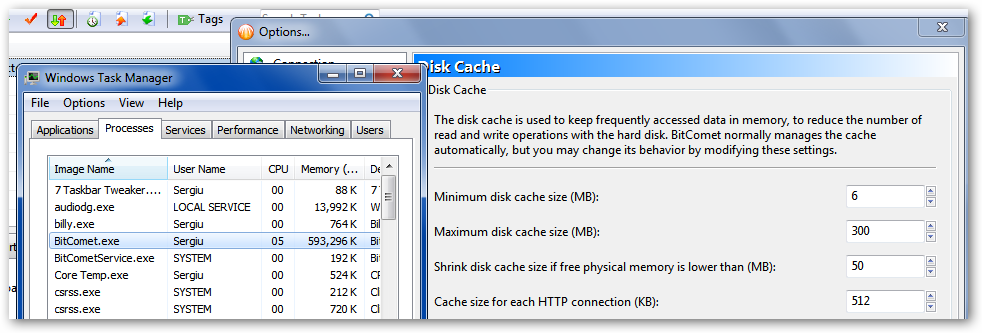

disk cache is not working on 1.26 see pic.

You are joking right? i have set disk cache to 300 mb ( to load in RAM memory ) and it’s loading in memory 600 MB. Doesn’t the pic say it all ?
Actually, what the picture says is that BitComet is using 593MB of RAM. I doesn’t say at all that those 593MB are all cache memory. I don’t know how you arrived to that conclusion, hence my previous post.
Following your line of logic it would mean that if you set the max cache size to 0MB then Task Manager should indicate 0MB memory use for the BitComet process. As if the executable doesn’t use memory for anything else but cache.
At this point if you can complain about anything at all, you could complain that it used too much of your memory. But from this single screenshot there is no evidence that **all **that memory is being used for cache. Nor at least, how much of it is being used as cache.
I’m not denying any possible issue, just saying that your picture doesn’t support your statement.
Oh , i have uninstalled 1.26 and installed 1.25 and set it exactly like the previous one,it will not load more then 350MB in memory if i set maximum to 300 MB , try it yourself and tell me if there is a bug in 1.26 or not. 300 Is the maximum cache and like 24-50MB it’s used by BitComet please give it a try and let me know if you agree or not. Something is not good why in 1.25 will not go over 350MB if i set cache to 300MB and in 1.26 it will reach even 600 MB , how come? this is the question.

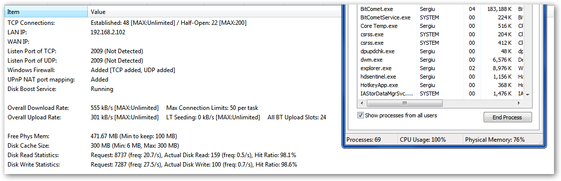

Ooops. Totally forgot about that, but you should be able to see the amount of RAM used for cache at any point by looking on the Statistics tab (in the lower area).
Posting a screenshot of that tab, at a moment when it exceeds your set limit, should be a clear enough proof of BC stepping out of its bounds, so that when the team came back they could add this on their to-do list.

There is a new problem , in the statistics tab disk cache is not indicating very good how much it uses,look at windows task manager and statistics tab disk cache.

Have you looked at the cache size reported by BitComet when you HDD goes berserk? What does it show?
Does its cache usage readings look consistent with what Task Manager displays as amount of memory used by BitComet?
