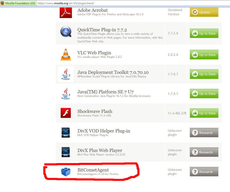

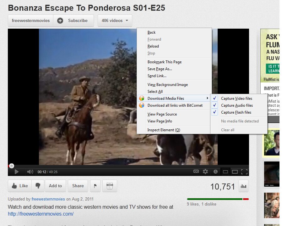

Hello I’ve loved bitcomet for years. So much that I even stopped updating my other programs (firefox,add-on, etc) because it wouldn’t allow bitcomet to see online videos and audios. Yet I could only do that for so long till the flash drive gave me problems and I updated everything. I went to the new Bitcomet 1.34 (64bit) but it doesn’t detect any flash files. I’ve tired downloading 34bit or past bitcomet but still doesn’t seem to help.
I’m currently using 1.34(64 bit)

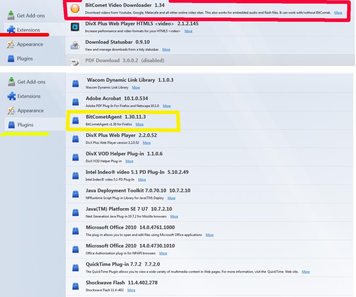

The bitcomet 1.34 is in the extention
But the bitcomet 1.30.11.3 is in the plug in

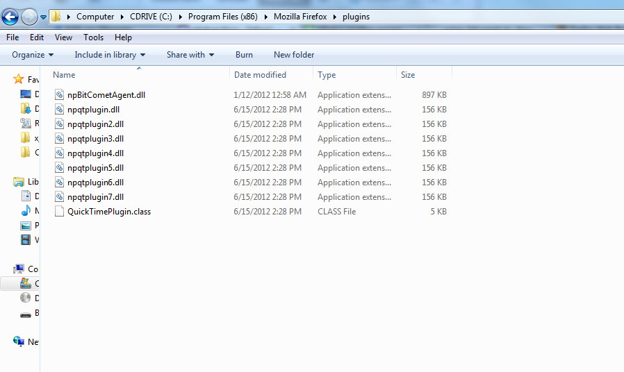

I tried going into the firefox plug-ins to delete it manually but it still shows up. After uninstalling the program it looks like I can manually delete it but when I reinstall it it shows up again.. Yet even if I get rid of it I’m not sure if its enough to get Bitcomet to detect the flash files online.
I’ve tried uninstalling firefox and reinstalling. Even deleteing all the bitcomet files after uninstalling to see if that can clean up anything.

The information on the images will tell you about my current plug-ins.

Now that one didn’t have firefox either. So after downloading them both. I sow that the computer also had the same plugin named differently than the extention. But just like mine it wasn’t able to detect the youtube video :mellow: either.
