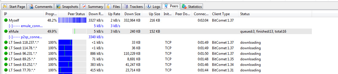

Hello all wonderful people and the most awesome developer team out there.
I have recently downloaded the Xtreme mod of the famous eMule Plugin.
The downloads are working fine green arrows are in both ed2k and Kad.However the uploading stays at zero percent on my plugin even when there are many peers with incomplete downloads.
The BitComet uploading works fine.
My ports are ok and I have adjusted by settings in eMule so as to optimise my download/upload speeds even then uploads queue is empty.I have downloaded several files on the plugin through BitComet still uploads are zero the eDonkey networks.
Eagerly waiting for Eagle sir’s response.

Like all p2p protocols ed2k requires that you’re connected to a peer that requests upload from you. The presence of incomplete peers isn’t enough to assume there is a problem, it’s likely they are already receiving as much as their bandwidth can handle. I’ve used the emule plugin for years, never tried the extreme version but I have witnessed difficulty uploading similar to a torrent with lots of seeders and few peers. Usually if you keep the tasks running they will upload and if any of the files are also shared in torrents you can upload to those bitcomet peers in the torrent swarms too. This is one feature that makes bitcomet unique, it can share using cross-protocol technology that as far as I’m aware no one else had developed.
My best guess is you probably just need to wait for a “hungry” peer and it will upload, but I will admit I have limited knowledge of ed2k protocol. I’ve studied how it interacts with bitcomet’s cross protocol downloading, but as far as using it to download files on it’s 0wn I’ve only done when I can’t find something in a torrent. If you’re certain there is actually a problem you might try emules forums, or install their stand alone client and see if it uploads on the same tasks.

Here is a screenshot showing emule uploading
/monthly_02_2015/post-1287-0-01336800-1423477429.jpg" rel=“”>
After the download completed my upload speed to the peers increased, it’s still only about 20kB/s but I suspect these two peers are very slow as I rarely got more then 2-3kB/s from them. After waiting about half an hour I enabled LTseed and the torrent completed in a few minutes.

You were right!!
I installed the original eMule plugin this morning and the bug got fixed! Now I can download and upload simultnously!! WOOHOO
Looks like the Xtreme mod is not so good after all. My PC is ok. I will use the original one from now on.
