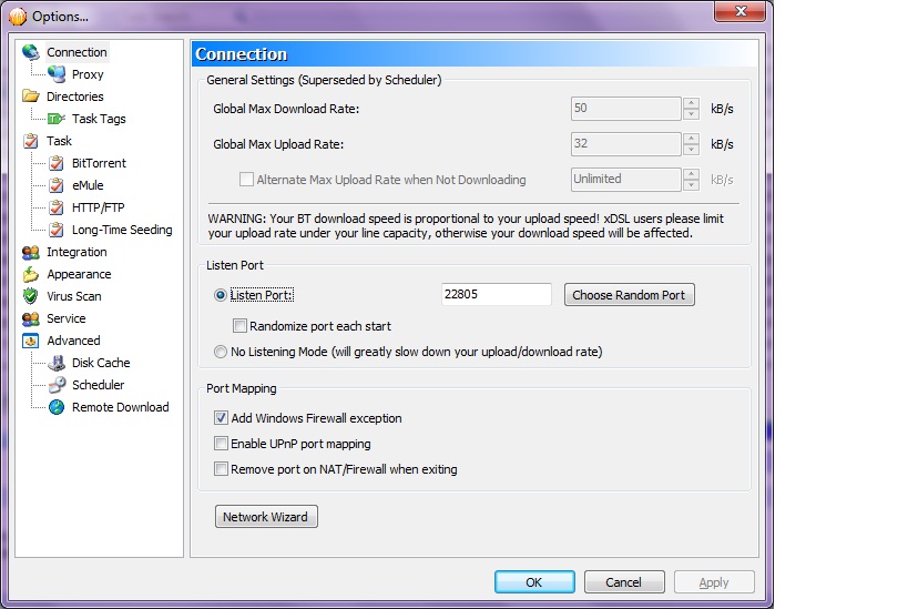

My upload speed used to be 100 and I could upload files really quickly but I think my brother changed the settings because it’s only uploading at 20 and it’s taking days to upload now and I don’t know how to switch it back.
I go onto the bitcomet’s options and I can see in the global max download rate it’s 50 and the upload is at 32 … I know these 2 use to be unlimited but the boxes are greyed out, so I can’t change the numbers. I tried going into “task” then “Bittorrent” and the upload rates are at unlimited

There isn’t any setting in BitComet that I know of, that will gray out the two boxes which configure the maximum Upload and Download speeds in BitComet.
Can you post a screenshot of that page?
If that is really the case, you’ll probably need to do a reinstall.

Hi,
Ok so here’s the screen shot.
As you can see the spots where you can change the max download/upload speeds are set to low speeds and greyed out so I can’t change it. I’ve been googling everything and I can’t find a solution, if you don’t know any other way to change it then I’ll try re-installing it. Thanks for your help!
**I know for a fact when I downloaded bitcomet I had the settings on both set to “unlimited”… I just can’t figure out how it’s been greyed out.I used to upload at high speeds now the quickest speed I have it 25kb/s … and that’s for the popular torrents!
/monthly_02_2011/post-60861-12966259581315.jpg" rel=“”>
You can’t? Even though it tells you why?
It says, right there, “Superseded by scheduler”. So go look at the scheduler.
Wow I was looking in the wrong place because someone told me to go into “tasks” and nothing happened. I totally missed the “scheduler” option, thanks.
