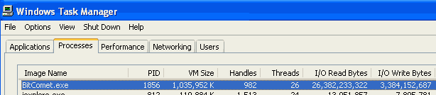

Hi, BitComet on my machine sometimes uses more memory than I think is appropriate and commit size grows over time rather than reaching steady state. (E.g. Over 1 GB commit with 512 MB physical.) Is this a known problem? I did not see other posts or notes in the FAQ about this magnitude of memory usage. Are debug symbols available to help identify the cause?
Sometimes BitComet.exe will consume less than 200 MB after running for hours, but sometimes it grows excessively. For example today after about 12 hours the VM size as shown in Task Manager is 970708 K. It is not a leak because when exiting cleanly the commit size comes down to 32 MB at the point kernel32!ExitProcess is called. The current BitComet rate is roughly download 2 kB/s, upload 85 kB/s.

/monthly_07_2010/post-58064-12802183468559.png" rel=“”>

BitComet starts off using about 60MB of memory and ends up using about 1.2GB after 24 hours.
