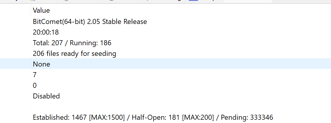

/monthly_2024_01/Screenshot2024-01-12172845.png.b4c1aafde1aacb51fdb8db0448f4c586.png" class=“ipsAttachLink ipsAttachLink_image” >

	2.05 is already the latest, see screenshot
	I don't know what to say for the suggestions of connecting one by one or reboot, but thanks anyway
Please see screenshot carefully, I am talking about "pending" connections, not established / half opened connections, currently there is no way to limit pending connections. Pending connections is the one causing the issue. As far as I'm aware, pending connections are not opened connections, from my network monitoring. If they are, then there is a flaw in the program because you cannot limit this number.

	Why there is no Advanced option to limit pending connections, obviously it gets out of control when it blows up and the program gets into an unusable state. The screenshot above is showing 300,000+ pending connections and the UI lags so much, while i have a good limit in place for global maximum number of connections and half open connections
