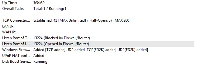

No Matter what i do tcp is always blocked. I created the rules for firewall,UPnP working.
Router is a INTELLINET NETWORK SOLUTIONS Wireless 300N Broadband Router model
** 524490**

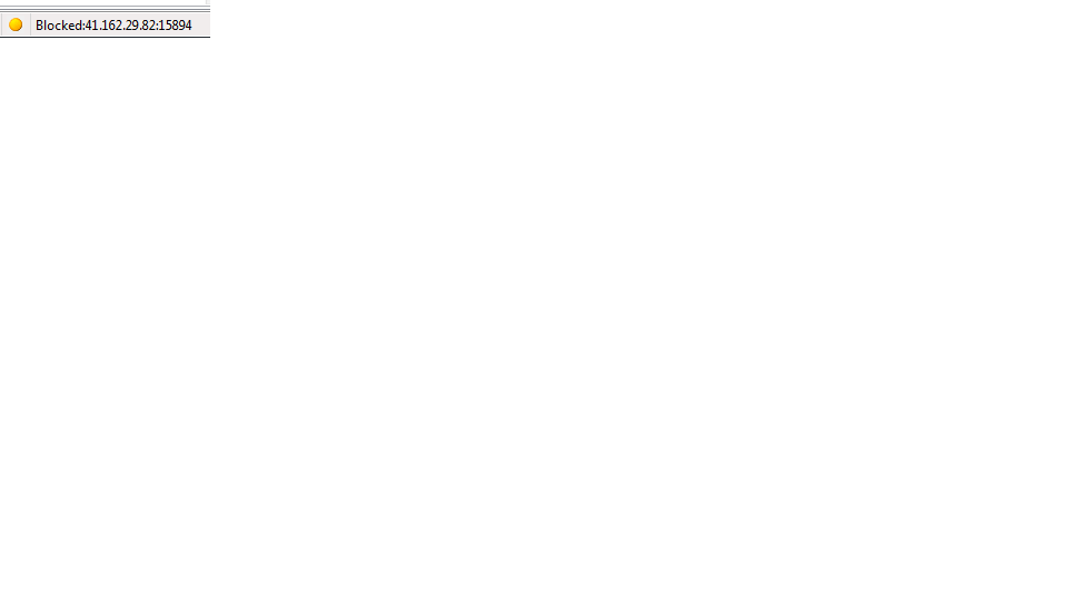

Your screenshot doesn’t show the port as blocked, what evidence do you have that it’s blocked?
cassie, you did pretty good but I can see the screenshot, however it looks like text.
Sorry about that. I did not notice here is the proper screen shot
/monthly_11_2014/post-150513-0-69118900-1415394785.jpg" rel=“”>
What is the status of your port check indicator, green, yellow or grey?
Have you checked the port on canyouseeme.org?
The colour is yellow as it says blocked. I have and it says it can see me when i use port 80 but if i change the port to 13224 it says

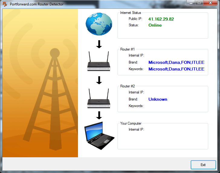

If you have dsl there is also a modem which may also have a router in it. Check the article on cascaded routers on wiki.bitcomet.com, it should be helpful in determining what you have and what you need to do. One simple check you can do is look at the WAN ip address on your router, it should be similar to 41:162:29:xx, if it’s not you most likely have a second router. If your router plugs into any sort of telephone device other than a jack in the wall, then it is probably a router.
My internet goes straight to a wall jack. This is the message by the yellow light i get
/monthly_11_2014/post-150513-0-55241900-1415534592.png" rel=“”>
Using portforwarder app gives me this. Guessing that means i have 2 routers?
