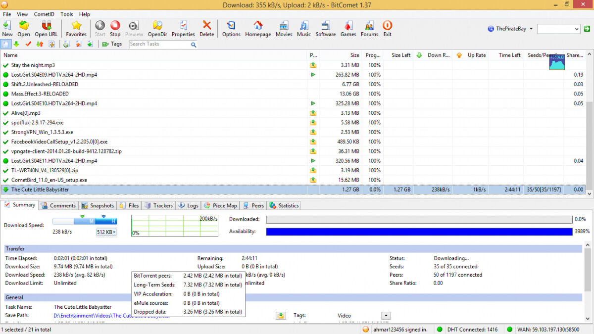

So I have attached these screen shots with the post…the first 3 screens show the data wasted and the seeds connected to the torrent file…
the last screen shows the wastage of data after I have done that process…It was still wasting the data…but with other torrents the problem seems to resolve after the hash check but with this torrent it didn’t…
So it is possible that the problem could be with specific torrents but I guess you guys should check it…I have a limited usage Connection so it is a massive problem for me…it really wastes like so much data.

Regarding your screenshots, I think we’ll need to see the results after significant amount of the torrent has been downloaded. With less than 1% complete the stats won’t provide any useful info.
