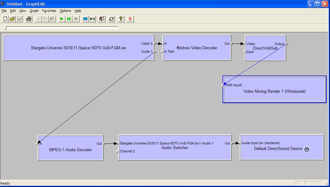

As I said this looks odd.
It seems that MPCStar is building the entire filter graph as it should.
I know that you may probably have already checked this that but MPCStar has 2 independent volume controls so I have to ask before going any further: Have you checked the Volume Setting Panel as well, under the Audio menu to see that the volume is set to maximum for both speakers and that the speaker type is the right one?
If yes, then you should download a tool called *graphedit *or graphstudio; any of them should do.
After that, open the file in MPCStar and then start graphedit.
Go to File–>Connect to remote graph… and you should see a little window with the PID of the MPCStar process.
Hit OK and then you should see in the main *graphedit *window the filter graph (filter chains) represented as rectangles interconnected with arrows.
You can drag the rectangles so that they all fit inside the window and after that take a screenshot.
This should give us a confirmation that the filter chain is properly built.
If that’s the case then probably we can forward this to the team.
Also, what is your OS?
