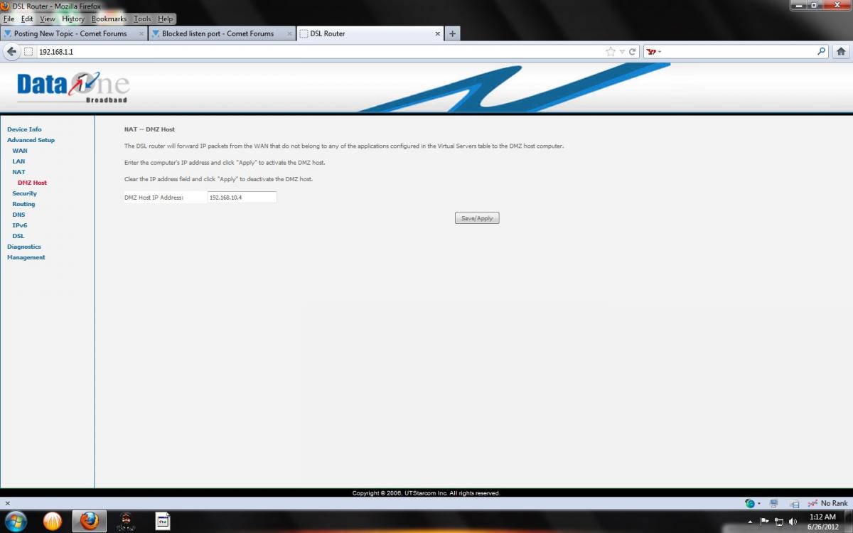

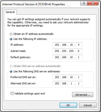

I am using the above modem and router for internet, connected with network cables. I have a problem, i tried everything (port forwarding, deactivating firewall, give static IP, deactivate upnp port mapping etc) to run Bitcomet smoothly. It took me very long time to understand all this.
Now after doing everything it still shows yellow light. Is their something more i need to check/do? Please help me, i have searched everything on internet to make it correct but still no solution. i have already tried http://portforward.com/ for help this website shows the new modem model (UT300R2U) and my router (RTN13U) is not even listed on it.
I am posting some of images for more details as attachments, let me know if more information is required, please solve my problem :(.

You have two routers here, so either both need to have portforward setup, or it looks like you attempted to bypass the router that’s built into your modem by using DMZ. I don’t know how these devices are wired together, but it looks to me that you’ve set your computers IP to be in DMZ on your modem, but if I understand your setup correctly, you would want the asus router’s IP to be in DMZ, so all packets pass through your modem and go direct to your asus router, then the asus router will allow only the port you specified to pass through to your PC.
The only way you can put your computer directly in DMZ on your modem is if it connected directly to it, but it looks like it doesn’t.
You want the DataOne router passing things on to the next link in the chain. The next link is your ASUS router. In other words,
You set the DataOne to forward to 192.168.10.4 where your computer is. You should have set it to 192.168.10.1 which is (probably) where your ASUS router is. You’re trying to “skip over” the Asus router, and of course, you can’t do that.

This is where your computer is, at 192.168.10.4
