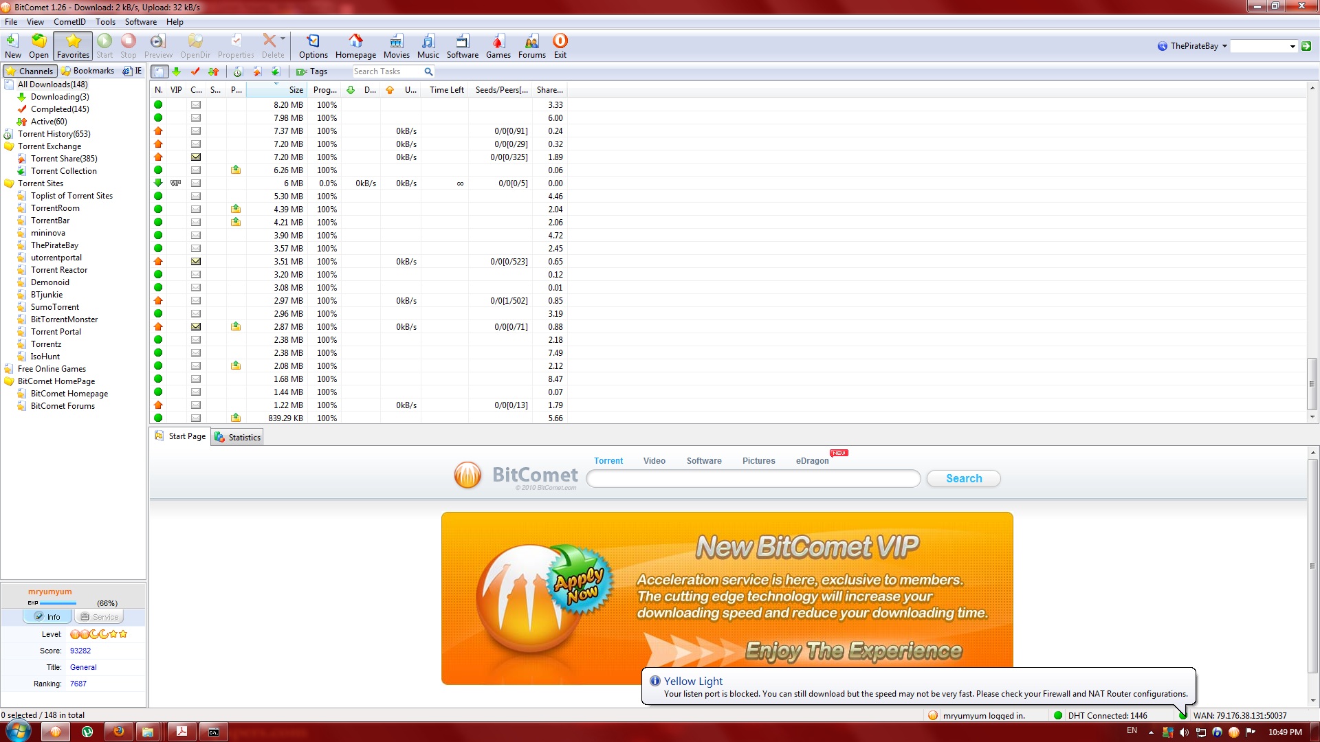

sorry for not making myself clearer, heres a screeny:
it happens when i try to change my listening port (i do this every once in a while since i believe my isp is blocking it after certain time of downloading), so basically i just change the port, press apply and get this message
