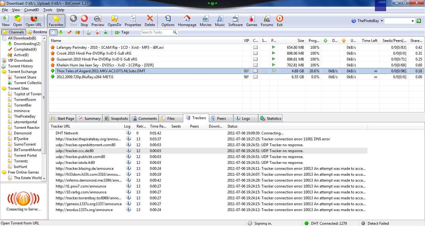

I have included a screenshot showing 0 uploads and also showing login error as it goes on and on but doesn’t get connected. It is also showing Tracker connection error 10013.

If you will look at the messages from the trackers, you see that you have not connected to a single one of them. This is the gross reason for the failure – that you haven’t been given a list of peers from any of the trackers, and haven’t successfully added your address to any of their lists.
DHT is still waiting for any kind of answer. You’re getting a DNS error from TPB because they took their tracker down two years ago. You’re getting a host of “no response” errors from UDP trackers.
You are getting winsock error 10013 from all of rest of the trackers. Now since this is a network error, not a local filesystem error, and it’s coming from multiple trackers, it indicates that you’ve got a network problem.
My favorite source of network problems, particularly for this error, is 3rd-party firewalls. If that’s your problem, changing BitComet versions won’t, by itself, make any difference. Because of your circumstances, going back to v 1.22 just might.
You said that you “didn’t know” about any firewall or antivirus. I suggest you find out. “Yesterday” would be a good time for that.

I have to agree, it looks like your being blocked by a firewall, or security program. You may have gotten a notice that there was strange network traffic that could be an attack, and asking you if you want to block it, when it was in fact connections you invited when you joined a torrent.
Also, since you have downloaded some tasks in the past, it’s likely that you were prompted to give bitcomet permission to connect to the internet through your firewall, but when you changed version of bitcomet, that firewall rule no longer applies. Most firewalls will tell you a program has changed, and asks if you want to allow it. If declined, you’ll get a similar situation that you have.
Your definitely going to have to figure out what firewall and/or security software your using.
