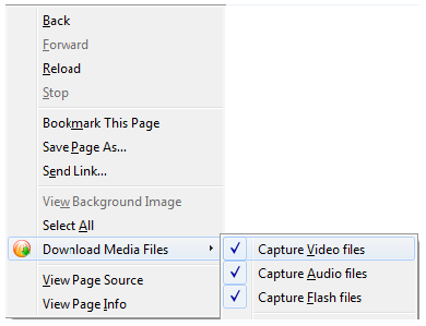

I wonder why suddenly i cant download anything using media files function..
As always i download many video in web, i play the movie, left it until the end, put the cursor out to empty space and download the video…no problem until now, i just cant download the video…play the video, left it to end, then i try to download in download media files section, it just dont show any files that i can choose to download..just nothing…everywhere i point the cursor and try again, same…nothing file to download…how can i fix that?i try restart or reopen cometbird, but still same problem…i thick all 3 capture option, still no files to choose.

But in my case, i can’t use media files function at all…its just no files to choose…only capture option…either i tick or not, there is no files below that…not even word ‘no media file detected’ below that…
Its something about tools that i turn off accidentally or something block it or what?

/monthly_03_2011/post-62012-13001679009452.png" rel=“”>

i’m also facing the same problem after i upgraded to cometbird version 3.6.15
it cannot catch any media on any site.
You should try downgrading to whatever version of Cometbird you had previously, and see if that still works where 3.6.15 does not.
IF the previous version works, then it’s probably something wrong with 3.6.15. If the previous version doesn’t work either, then it’s likely something else in your configuration, or something at the web site changed, possibly for the very purpose of foiling downloaders.

It works when i uninstall CometBird and install the older version again, but CometBird upgrades automatically sometimes… I just wanted to inform u guys that there is a problem in the version 3.6.15 which not only I but many other users are also facing. Its not only the case for YouTube videos but version 3.6.15 cannot catch audio and flash files either. I’ve tried finding updates for the Add-Ons such as “BitCOmet Video Downloader” but no luck. So please see to it and corect the problem in the next release. :slight_smile:
In “Options>Advanced” on the “updates” tab you can select if you want cometbird to search for updates, and if you want it automatically installed if found.
