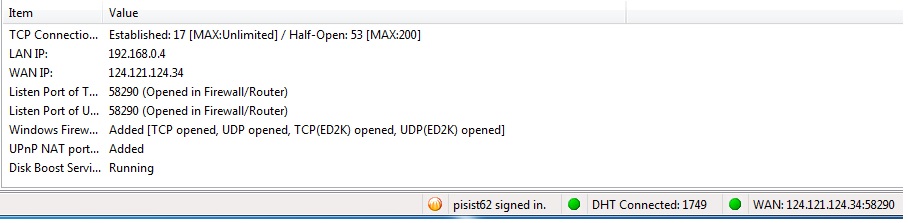

BitComet is stop downloading at 4PM and start again at 6AM everyday. I made forward port and WAN status is green. All firewalls are open for BitComet port 58290. I do not know what is exactly problem. Internet speed is not down. Other download is fine. I did format HDD and re-install Win7 and BitComet but problem remains the same.
/monthly_2016_12/585d298cda3d8_Untitled1.jpg.c26a1df5adea64f1ba2c27cee0020099.jpg" data-fileid="2663" rel="">![](/monthly_2016_12/585d298cda3d8_Untitled1.jpg.c26a1df5adea64f1ba2c27cee0020099.jpg)

Check the settings on your scheduler within BitComet, if you or someone else has set it to not download during those times it will behave as you state, otherwise you may want to contact your internet provider who may throttle p2p downloading during certain hours.
BitComet will not stop downloading at certain times unless specifically instructed to do so.

Thank you for your advice. I cannot find this phenomena in any where else. I will try to find the answer. Thanks again.
PS: I basically did dis-able schedule.

I have this problem since long time until now.   I notice that you are using True internet provider same as me (Chatujak area)
The symptom is the same as you mention.  It does not stop at 4 pm but it will be very slow from 4 pm to 6 am.
There is nothing wrong with Bitcomet and I thanks to Bitcomet that the long-term seeding feature does it job very well even
I do not know how it works.
After 4 pm most download I get is LT seed:Bitcomet member.
This problem had been discussed with True internet provider but nobody give me an answer.
My personnel thinking is that.... there is a bandwidth Load sharing switching between area after 4 pm.
