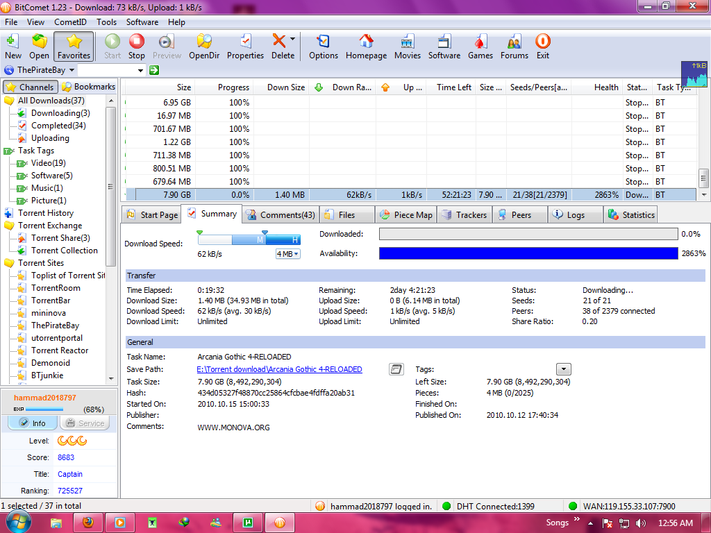

Post a screenshot (maximized window) of the Summary tab of such a torrent which “downloads but doesn’t download”.

This is the screen shot of the downloading process, sir.

By the sentence ‘every other thing is pretending to be as normal’,
I meant that bitcomet is behaving normally, like getting speed, showing the downloaded amount of data, green port forward sign, but the PERCENTAGE does not increase and the data ACTUALLY isn’t downloaded.
You can see that the download file is of 7.90 GB. That means 7.9MB should have been downloaded to increase the percentage to 0.01%, but I’ve downloaded 35MBs in total (u can see in the screen shot) but the Percentage hasn’t moved a bit.
Note: for other torrents, I did download a lot more than just 35Mbs, but the problem remained the same.
If you need any other information, plz let me know.
Best regards, thanks a lot.
Well, you’re wrong. 1GB = 1024MB not 100MB, so 7.9MB out of 7.9GB is less than 0.001%. But in fact you have downloaded only 1.4MB of valid data. The rest up to 35MB is garbage data. Since BitComet displays only 2 decimals it’s no wonder that you didn’t see any increase in percentage.
The percentage is calculated using the amount of valid downloaded data. The garbage data is being discarded because it’s useless.
The first think I’d suggest is that you try some other torrent than a new-release game. That has a very high probability of being a poisoned torrent which is not ever intended to succeed, but to frustrate you into giving up.
