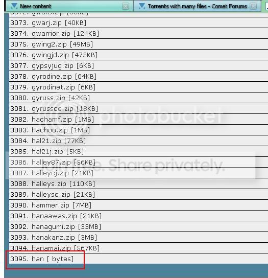

Wiz, I see that you have already tried it out, and was wondering if (perhaps) the poster was having problems because the very last file does not show any size (it juts says “bytes”, but doesn’t mention how many)… or is this just completely irrelevant (which, by the looks of it, it is)?

I meant the one shown right on the index site, here…

That file list on the site is both inaccurate and incomplete, cassie. The next file after hanmai.zip is not *han *but hanamomb.zip (furthermore, there isn’t such a file named “han” in the whole torrent) and the total number of files in the torrent is 8745, not just 3095 as shown on the site.
I don’t know if the number of files and their file-names is automatically being retrieved by a script or manually done, but either way it looks that something/somebody just got bored and stopped mid-way. :smiley:
On this matters, the info shown by the client has the last word since it’s being read from the actual .torrent file for that torrent.
