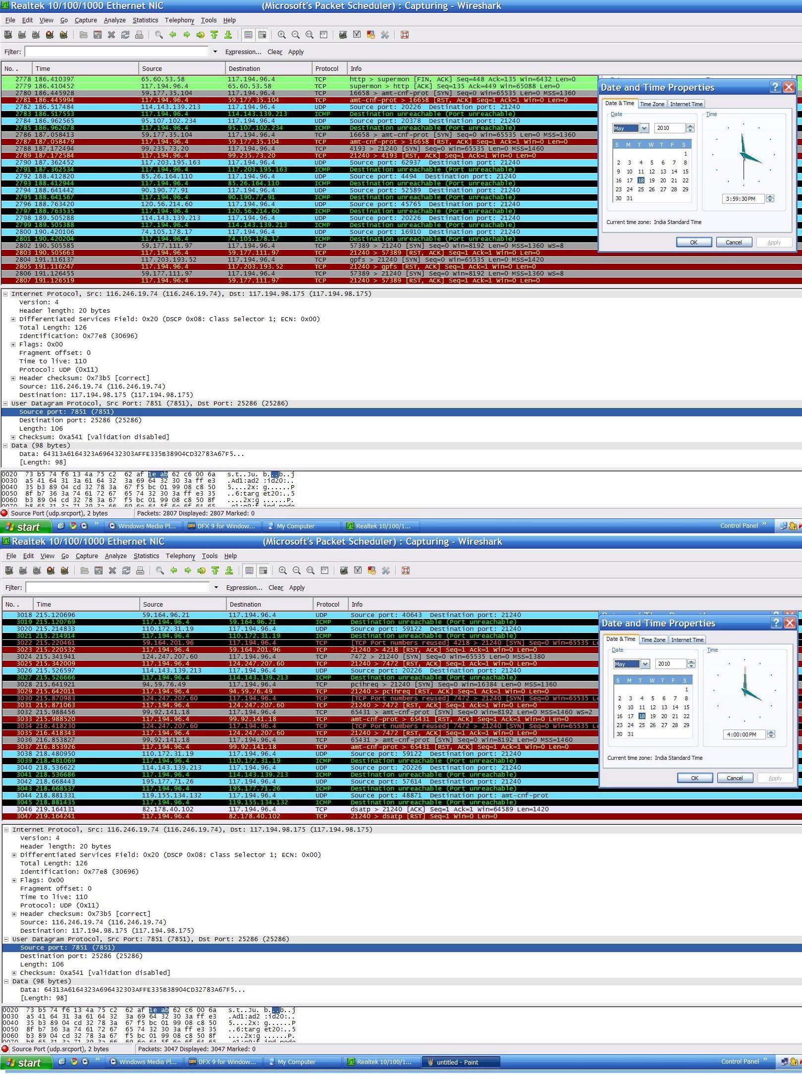

well in this case i tried to use wire shark i too much complicated i surppose but i send u all the status i found after the test running normally without any type of application and for 30 sec and running with bitcomet status for 30 sec like now what do u say i have also uploaded the exported files for wire shark download it from here

see the photos for the status
/monthly_05_2010/post-53766-12742991197792.jpg" rel=“”>
/monthly_05_2010/post-53766-12742990949415.jpg" rel=“”>

It would actually help a lot more if you told us what was your IP and your BitComet listen port, so that we could spot easier the traffic belonging to BitComet (at least the incoming one).
Furthermore, have you applied the advice I gave you in my previous post, to check if you still get increased traffic?
You have yet to determine that the extra traffic belongs to BitComet not simply assume that.
i have already made disable DHT, LT-Seeding, e Mule plugin and Torrent Exchange u can see in the photograph there is no task running
my listing port is 25286
And your IP in the Wireshark capture?
what will be the ip in the wireshark goto to this link and download all the status exported from wireshark u can get the in all the information try once
http://rapidshare.com/files/388707670/status_wire_shark.rar.html
I’ve already downloaded the capture file before asking for your IP. I could probably determine it from scrutinizing the file but I don’t really feel like fishing for your IP through several hundred lines of capture just because you’re too lazy to tell me your public IP.
If you feel strong about your privacy, you can send it to us in a PM.
We just need to be aware of your public IP before starting to inspect the capture file so that I can differentiate the incoming traffic from the outgoing one, from the very beginning.
It would be helpful if you told us as well, for which network *interface *you did the capture, if Wireshark was running in *promiscuous *mode or not and what is your network setup (router, modem, Internet connection, how many PCs and how are all these connected between them).
The IP address that you gave me is not present in the Wireshark capture file that you uploaded. Therefore I’m going to assume that your IP address in the capture file was the one with the same /16 subnet mask as the one you gave me.
It probably changed by DHCP in the meantime.
All that I can see in your capture file is lots of UDP datagrams, outgoing or incoming on the BitComet UDP port. However, virtually no TCP traffic whatsoever. In BitComet most of the UDP traffic is generated by DHT.
But I’ve already told you do disable DHT, LT-Seeding, eMule and Torrent Exchange ina previous post and YOU SAID THAT YOU DID THAT! And you complained that you saw no difference.
Then tell me how come that you have most of the traffic occurring using the UDP protocol on the BitComet UDP port?
Besides, even in the screenshots you posted, the Status Bar of BitComet shows that DHT is enabled!
If you really want to find solutions for your problems, you need to really start paying attention to what advice others give you.
sir i am sorry about i was not aware of what dth is now i can see the changes in bitcomet its working fine thanks,not using any single bandwidth in any time many thanks u don’t know the value of this for me now i can download freely with no tension but can u add a feature like u said that disable dth while scheduler off the task
