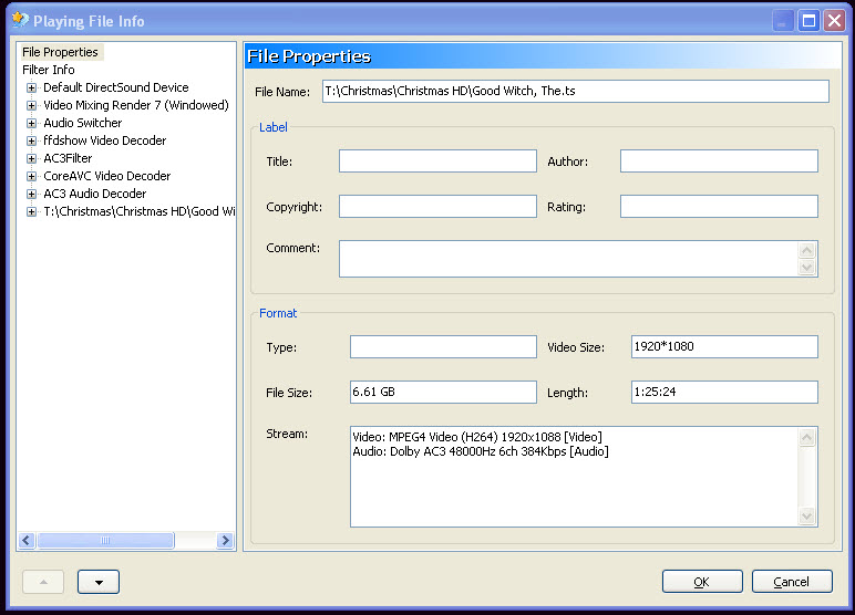

There is a menu (under File–>Info if I recall right) which will display the filter chain in MPCStar. Post a screenshot of that.
Let’s see what filters MPCStar uses for playing this file.

Well, I said to post a screenshot of that window with the collapsed view of the filters, just to see all the filters present in the filter graph. Details on any one of them wasn’t relevant at this point.
Sorry for the delay.
I hope the attachment works.
/monthly_11_2010/post-59507-12909546482022.jpg" rel=“”>
Looking at the filter chain, you can see that the Video Decoder it is trying to use is ffdshow. However, the media is in the transport stream form (which is what that .ts extension indicates), not the more usual Program stream form, and ffdshow doesn’t support ts.
However, ffmpeg does.
What I’d try in your place is to install CCCP and see if just doing that doesn’t solve everything.
If not, what’s needed is a way to tell MPCStar to use ffmpeg instead. Exactly how is beyond my knowledge, as I don’t use the program that much, and clicking on the video decoder for more info inevitably crashes it for me.
That’s a tad weird. It loads both *ffdshow *and CoreAVC. What’s under the *ffdshow *entry, when you expand it?
How about the *CoreAVC *one?
How did you go about disabling H.264 decoding in MPCStar’s copy of ffdshow?
That’s a tad weird. It loads both ffdshow and CoreAVC. What’s under the ffdshow entry, when you expand it?
How about the CoreAVC one?
