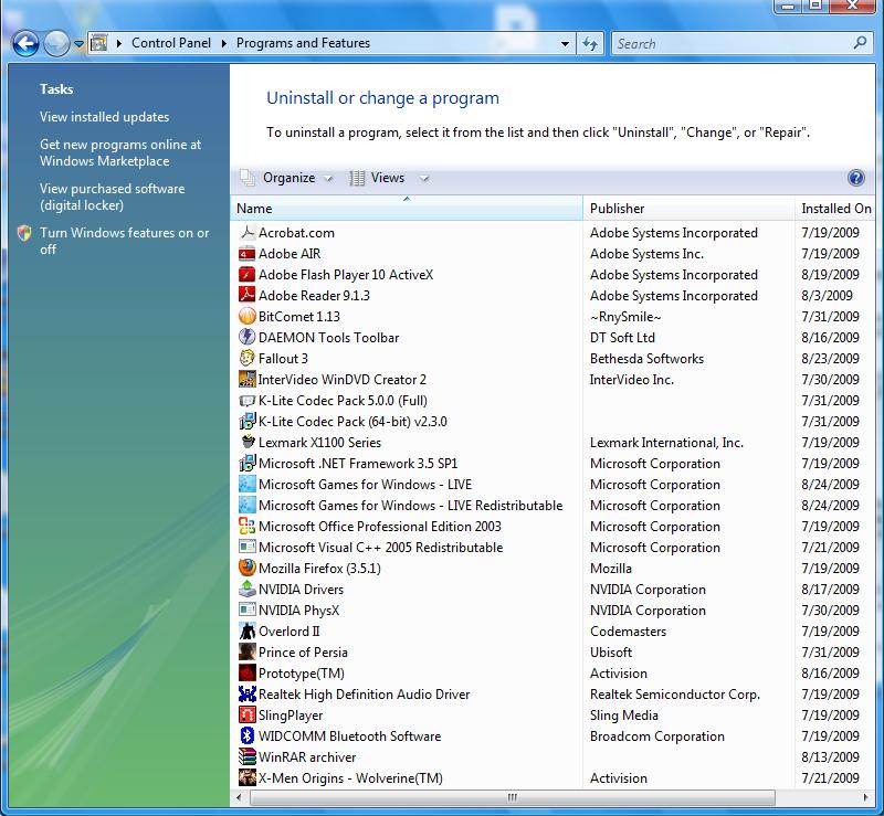

Here is a pic of my add/remove programs, in case anything pops up that sends a red flag.
/monthly_08_2009/post-54009-125130045022.jpg" rel=“”>
If you do have another firewall, it will be a running process. You therefore need to look at Task Manager, at the list of processes. You’ll need to identify all of them, using Google, and find that other firewall. You may well discover a lot of crap that you don’t really want running, this way.
I’m not familiar with Vista but I gather that this is, for some reason, much more difficult than it is under XP. It is still what needs to be done.
