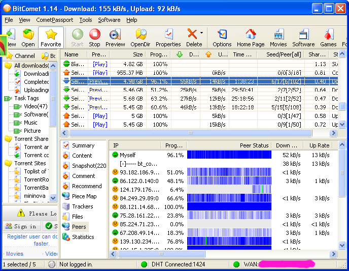

snmememe Posted August 18, 2009 Author Share Posted August 18, 2009 Issues continue same in 1.14. Strangely, I have come to utilise placing the mouse over that View_Torrent vertical scrollbar as a pause function, though it remains a hazard when I actually want to use the scroll bar as a scroll bar. I was wondering whether my description of patchy repainting required elaboration. In revisiting this, I found that perhaps the unreliable painting was dependent on having more columns selected than would fit in the horizonal space, and thus a horizontal scroll bar was also active. Here is a sample, after using scrollbar page down: Link to comment Share on other sites More sharing options...

snmememe Posted September 18, 2009 Author Share Posted September 18, 2009 What would be important is, if in safe mode, you no longer see the repainting problems, mouse messages, etc. Confirmed that in Safe mode on two WinXP SP3 uniprocessor systems, a painting problem was observed when using the torrent view vertical scrollbar page up/down. The cummulative column width didn't seem to matter. Typically the cell border lines look as if misplaced. I have already reported seeing that in safe mode the process can go full busy utilisation, at least when mouse is over the status column occluded by the vertical scroll bar. snmememe, is it possible that your computer run slowly? So when you use scroll bar, it will take more time to recover? The machines are 2000MHz class AMD of different types, plenty of memory, different video adapters, and not particulary busy doing anything else. Link to comment Share on other sites More sharing options...
