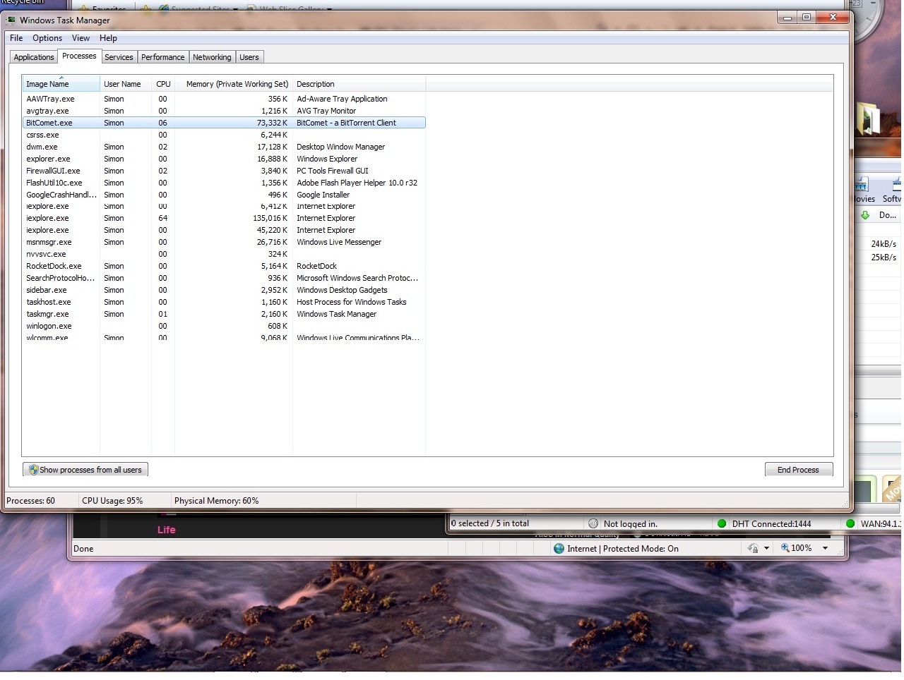

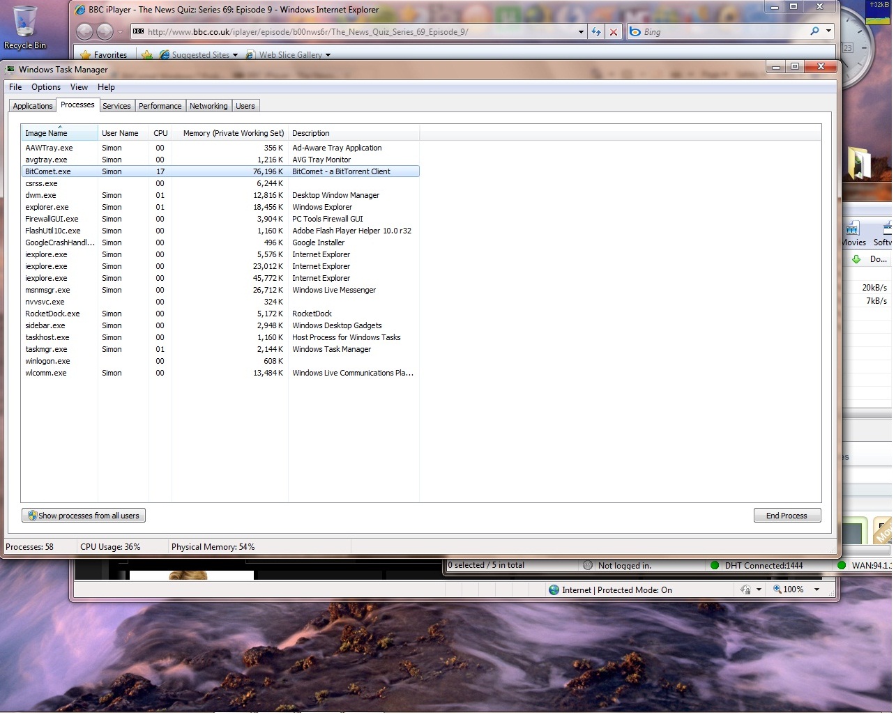

matress_tester Posted November 23, 2009 Author Share Posted November 23, 2009 Hi. Thanks greywizard for replying: I appreciate you giving your time. I took two pics of taskmanager: the first was while listening to the radio online, and the second was when I was watching an online video. In both instances the sound was clipping, despite the much lower CPU usage in the first instance. This sound distortion stopped seconds after I closed BitComet in both cases. My motherboard is an ASUS m2n68-la, with an onboard nVidia graphics card (geForce 6150SE nForce 430), and NVIDIA nForce 10/100/1000 Mbps Ethernet. I don't know if this helps, but my problem doesn't occur when using JDownloader, which transfers downloading data much faster than BitComet does. Link to comment Share on other sites More sharing options...

greywizard Posted November 26, 2009 Share Posted November 26, 2009 Well, the pics you posted are not totally relevant. As you can see you have around 60 processes running but only aprox 20 showing. I guess you should click on the "Show processes from all users" to get the full list. Furthermore, in your second pic I can see that you have 95% CPU usage of which 64% is taken by Iexplore.exe (which is huge) but it doesn't show where the rest of 30 something % goes. Anyway, the first thing you should check is if you have the Nvidia firewall installed. It comes bundled even with Asus mobos chipsets drivers, as well as with the Nvidia Forceware drivers. If you have installed it (even unknowingly) search for it and uninstall it (disabling it seems not to work). You can also check for 2 of its processes (nSvcAppFlt.exe and nSvcIp.exe) in Task Manager, both on the Processes tab (with "Show processes from all users" enabled) and on the Services tab. If you see any of these running than you certainly have Nvidia firewall installed. If it turns out that you don't have Nvidia firewall installed then it must be something else. I'm not ruling out even the possibility of a bug in BC itself but since it's happily running on lots of other machines, it would have to be something very exotic. Usually it boils down to software conflicts. Unfortunately, they're not always easy to pinpoint. Now, the problem you describe is in fact 2 problems. If you complain about heavy CPU load, that's one thing. But if you complain about sluggish Internet connection, that's not necessarily related to the former. In fact, the first thing you should check is if you have the connection settings of BitComet set properly. What kind of connection type (xDSL, cable) do you use and what kind of equipment (modem's, router's make and model)? What speed? Furthermore, what are your connection settings in BitComet? Also, can you tell me what exactly is Bit Comet doing when it takes 60% of CPU? Is it after you performed some operation (i.e. adding some tasks) or just normally running? How many tasks are you running? Especially if you are adding tasks to your tasklist from Torrent Collection that will cause some very sluggish Internet behavior of the other applications, until BC finishes querying the for .torrents of those tasks (and either finds them or drops the task). Link to comment Share on other sites More sharing options...
