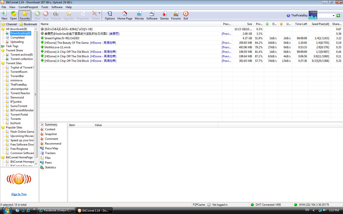

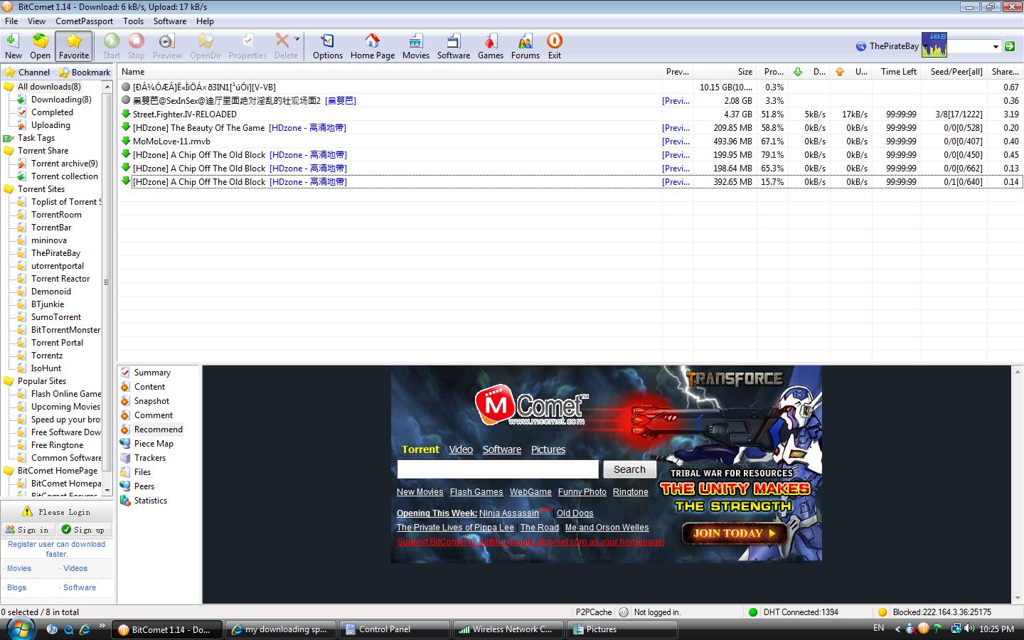

ladyr4in Posted December 30, 2009 Share Posted December 30, 2009 (edited) Hi all, As above, my downloading speed is slow while my uploading speed is much more higher. I had search & read the forum but im stil dont really knw wad to do... My max speed for uploading is to 15kb & uploading speed can be 60kb. But day time, downloading speed will be higher. Im using Vista, internet speed 54.0 mbps,using a router (my router is connected to the modem), Bitcomet ver. 1.14. I had done the speed test, shown results are 19.98 mb/8mb. :lol:I uploaded the print page,but i duno whether its help. (Im a computer idiot,thanks) =x :lol: Edited December 30, 2009 by ladyr4in (see edit history) Link to comment Share on other sites More sharing options...

roads Posted January 1, 2010 Share Posted January 1, 2010 (edited) like the rest said, your listening port is blocked, open a web browser and type 192.168.1.1 this will take you to your router. Depending on what router you have the user name probably will be User Name:Admin password:password if this doesnt work then just google search "whats my routers users name and password?" when you open the routers configuration page look for port forwarding/triggering then minimize the page and open your bitcomet and go to tool then options, click connections, on this page you will see Listening port, note what port it is set to. and minimize bitcomet. click start and then click run, in the box type cmd. when the cmd window opens type ipconfig. Look for IPv4 Address, this is your computers ip address your router has assigned it. open the router configuration page again and in the port forwarding section add the Listening port from bitcommet and assign the IPv4 address from the ipconfig window to the port forwarding. this will open your Listening port. There is also some other things you can do to speed up downloads but for now get that port open. Okay now that ports are open go back into bitcommet options and click Disk Cache. Heres something that sped mine up, I set the max disk cache to half of my ram 1g, it never uses all of it but it helped a lot, if your useing a computer without a lot of ram then theres not much you can do about it. Another thing is to limit the upload speed to half of your ISP upload speed, so if you have say a 20meg download speed and a 5meg upload speed then limit upload to 2.5megs, i have 5megs up but only have mine set at 250K/bs. hope this helps some Edited January 1, 2010 by roads (see edit history) Link to comment Share on other sites More sharing options...
