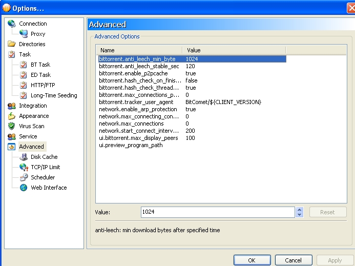

I do not know too much about P2P, just manageable I would say. Because of this I have also attached a graphic of my Bitcomet Advanced Setup. Even though I don't know too much I had not been disappointed so far. Now it is a different story. My suspicion is there is some malware issue, though I could very well be wrong. But I would be most grateful if you can provide any help. And yes, I have considered going for a VPN, but I can't do that right now.

The speeds you are seeing do not indicate any sort of throttling. They indicate that you have a closed listen port. This is explained in great detail, with multiple examples, in that thread.
I also commend to you the BitComet Wiki FAQ linked at the top of this page, particularly for matters like the half-open connections issue.
