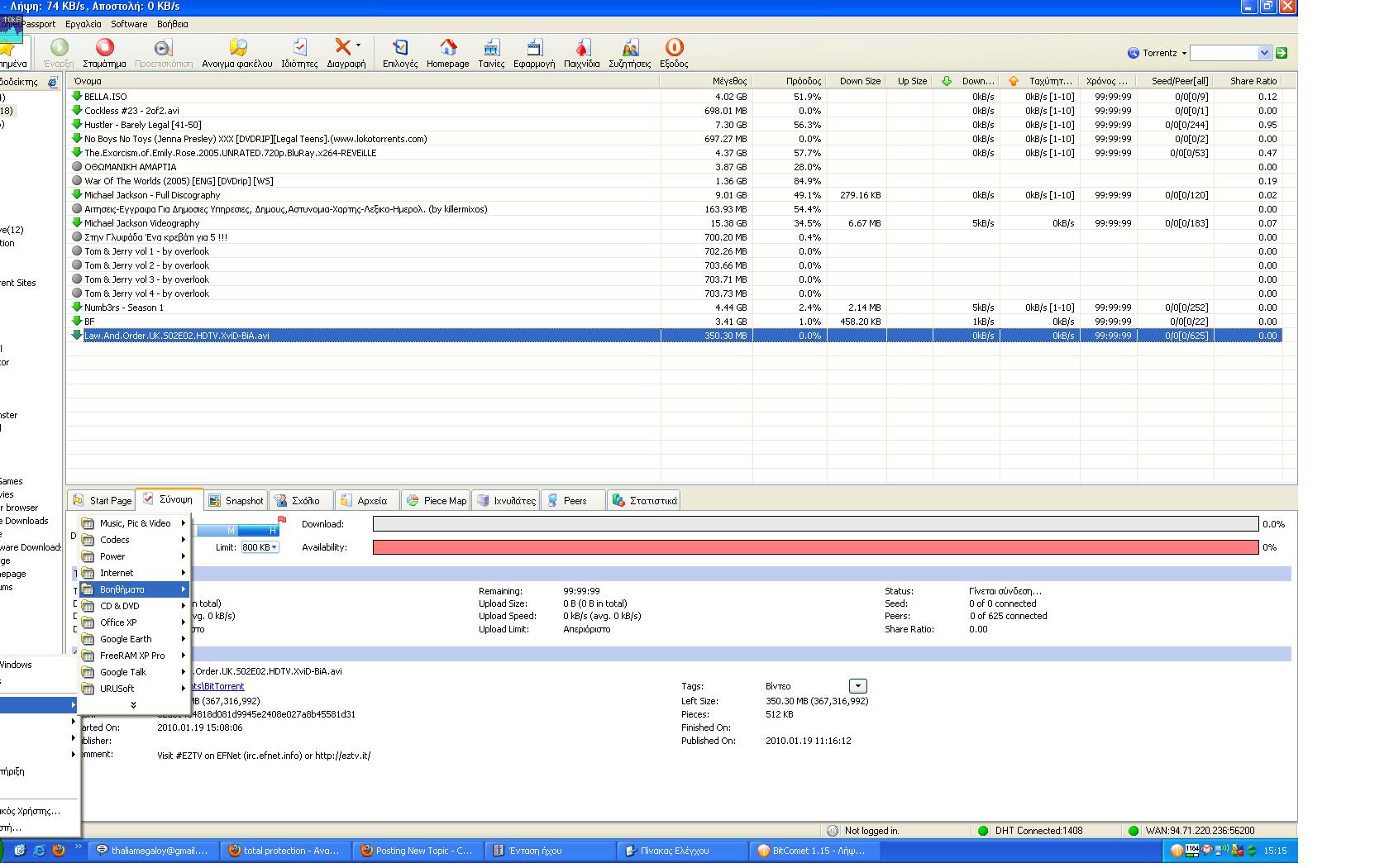

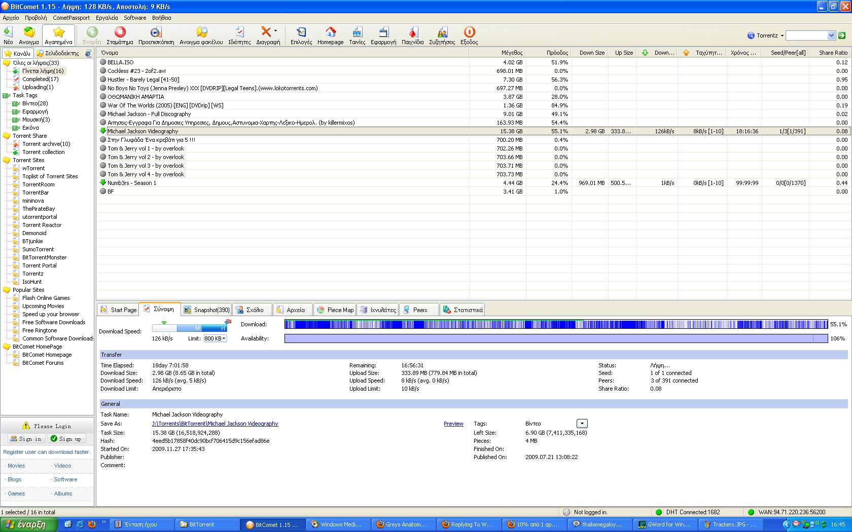

lyckos Posted January 19, 2010 Share Posted January 19, 2010 Hello I am using Bitcomet 1.15 I a have a 8 Mbit ADSL internet connection connecting wirelles to my router.... Windows XP SP2, AVG Antivirus 8.0, Spybot Resident Shield, Windows Firewall (Bitcomet exception added) As you can see in the picture attached, in the Seed/Peer column all of my torrents have 0/0 status even those that are active and downloading such as Michael Jackson Videography that says at download 5kb/s. Also I cannot understand why at the same column everything is [0/***]. This is supposed to be the theoritical peers and the last torrent (Law and order.uk) has had 157 peers and 255 seeders. What is wrong??? My sister who leaves in a different place at the same time and for the same torrent has [3/123] Another problem is that Bitcomet eats a vast amount of memmory that is gradually getting larger. When I oppen it it starts with 41 MBs and after 15 minutes takes 190 MBs and raising by the second (the numbers were taken by Windows Task Manager) is that normal??? Link to comment Share on other sites More sharing options...
greywizard Posted January 19, 2010 Share Posted January 19, 2010 The first two numbers in that column represent the number of connected seeds/peers; the numbers in square parenthesis show the total number of detected seeds/peers for that particular torrent (the whole swarm). The only problem I can see here is that you are not connected to any of the available peers for any of your torrents. You should check the Peers tab to see what happens. What are your connection's tested parameters (upload and download)? What are your general upload settings of BitComet? As for your memory readings, they don't seem particularly high for the number of torrents you run simultaneously since many of them have several GBs. What are your cache settings of BitComet? Link to comment Share on other sites More sharing options...
kluelos Posted January 19, 2010 Share Posted January 19, 2010 Consider what the numbers mean. Wiz explained them to you, so now look at them and think about them. Number of seeds you're connected to. Ok. Well, that's the problem, innit? Number of seeds in the swarm -- how many are out there, connected to you or not. Look at that number. Look at it for each torrent. It's zero. For every task in your list. nn/nnn[0/nnn] No seeders to be had at all. People do, for whatever reason, upload torrent files and then not seed them or partially seed them and then stop. Maybe they discovered an error, remade the torrent, re-upped it and are seeding THAT one. Maybe they can't seed for some reasion. Maybe they don't know they need to. Maybe life happened to them, their system broke, they got married/busted/divorced/called up. Anyway, it happens. It seems to have happened to every single torrent you list -- no seeders in the swarm. (Let me put that another way -- all of the other torrents this DIDN'T happen to have completed & dropped off the task list, so what you're left with is the collection of those that didn't complete.) In some cases there are a lot of leechers, but they are all in exactly the same position you are in -- waiting for someone to share any piece they don't have, but nobody has any such. Everyone in the swarm has contacted everyone else, everyone's at parity, has all the same pieces that anyone else has. Unless and until someone who has more joins the swarm, none of these torrents are likely to advance, much less complete. Should you give up on all of them? Depends on how likely you think it is that a seeder may reappear. You or somebody might post a message asking for a re-seed and that might work. Some of them might be temporary interruptions, or seeders who just haven't started seeding yet. (I usually start seeding before I even upload the torrent to the index site, to prevent this very thing.) Note the progress of each torrent. I usually give it a day (24 hrs). If it hasn't gotten off zero by then, I give up. If the torrent's well advanced and is something unique, I may give it 48 hours, but if there's still no progress, it's time to give up on it as unlikely to ever get any further. It doesn't hurt anything to leave it (not) running, but realistically? Dump it. Link to comment Share on other sites More sharing options...

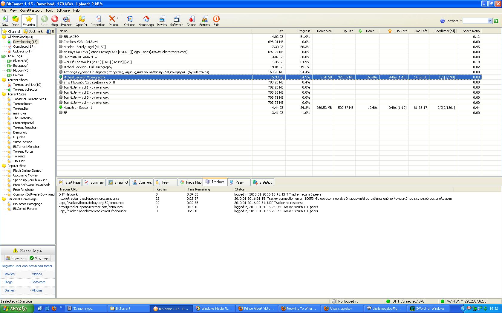

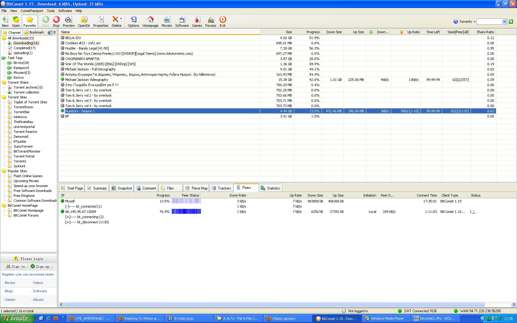

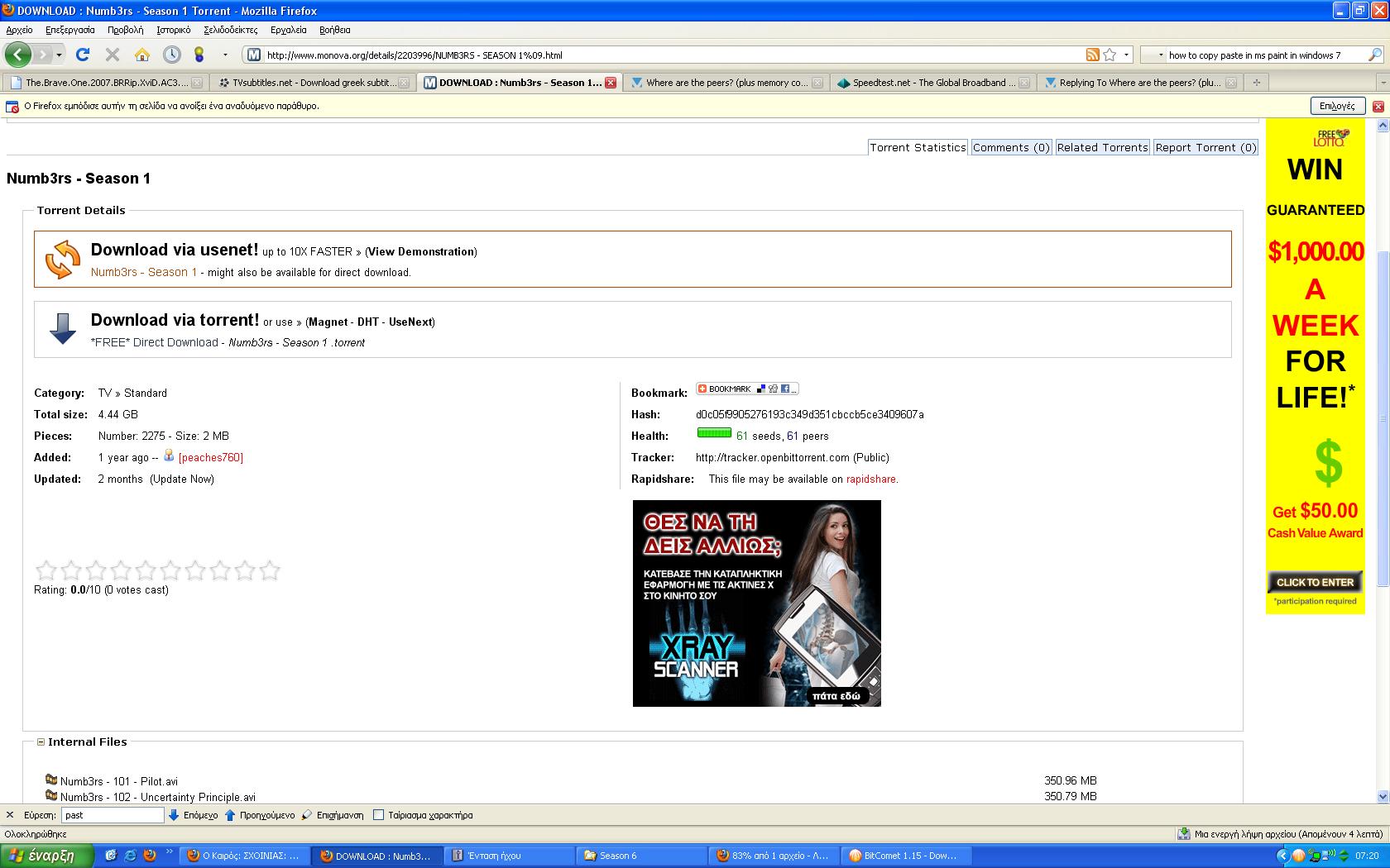

lyckos Posted January 20, 2010 Author Share Posted January 20, 2010 I am sorry for the delayed answer. That's what i meana bout the total number of detected seeds/peers. Most of those torrents have total numbers completely different that those on my picture, For example, the torrent: Numb3rs - Season 1 as you can see on the openbitorrent has 61 seeds and 61 peers, but in the bitcomet2 pic (my bitcomet) has only 2 total seeds, although there are 2 open truckers for it. Why? In speedtest.net my numbers are: Download:6,95 - Upload: 0,32. Global Max download rate: 800 Global Max Upload Rate: 32 Nat\Firewall and UPnP enabled Minimum Disk cache....:6 Maximum Disk.............:50 Shrink Disk..................:50 Cache Size....................:512 Auto choose cache........:Disabled I discovered that by reducing the amount of downloading torrents at the same time and having only 2 active, they had (as you can see) a little bit better speed than they normally would, but they still didn't connect to many peers or seeders and still the number of total seeds and peers was inexcusable low I just read the second reply to my post. My friend, kluelos. I believe i partially answered your interpratation of my zero (0) total seeders in the cloud. Let's make it more detailed. The Torrent Called: Mumbers - Season 1, has as you can see in the "openbittorenttracker.jpg" 61 seeders and 61 leechers in the cloud. EVEN if that is just theoritically then that one will convince you: you can see at the "Alternate User" picture that my sister at a different pc, but AT THE SAME TIME WITH THE SAME TORRENT has: 52 seeds ! ! ! and imagine that her port is blocked and mine isn't! So it is DEFINITELY NOT a problem of leechers here dear friend. Link to comment Share on other sites More sharing options...
