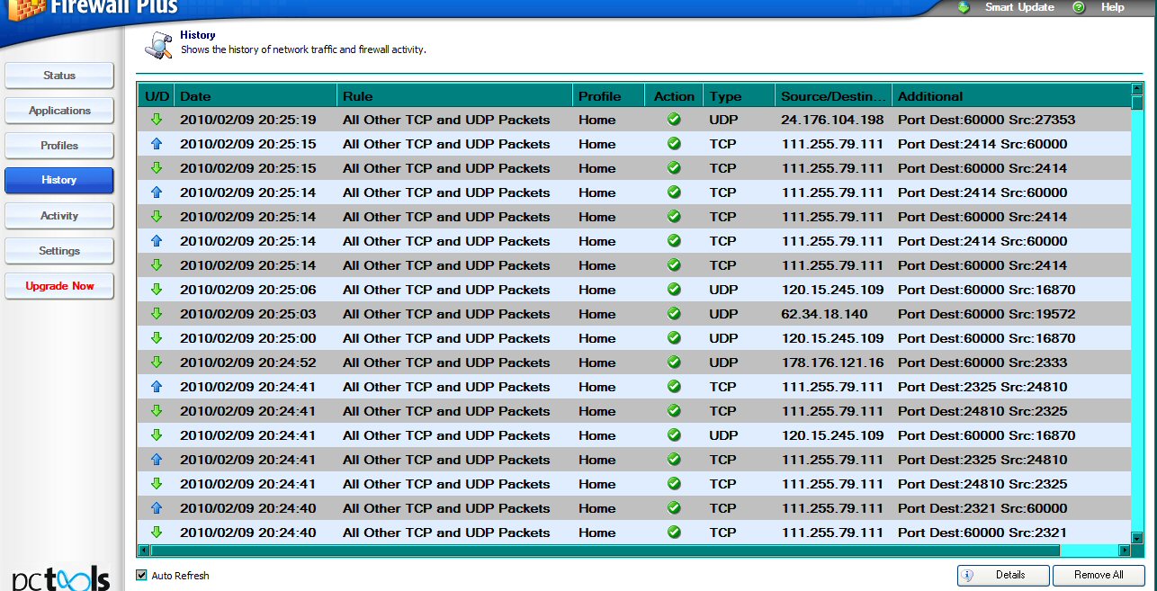

jgf Posted February 5, 2010 Share Posted February 5, 2010 On 2/4/2010 at 11:01 AM, greywizard said: Forgive my asking but how do you see traffic for eMule in your firewall if it's closed? An application has to have a running process in order for you to see traffic in any application which monitors the network (firewall, packet analyzer, etc.). Did you actually check the process list to see if eMule's process is really closed or just hidden? And where in your firewall did you see traffic for eMule? I look under the "history" tab, which shows all incoming and outgoing signals, giving date, time, type, port, etc. For example, I just checked this data - the four most recent items show a destination port of 60000, which is Bitcomet's listening port; the next three items are for port 55000, which is emule's listen port. The next most recent is outgoing from port 60000, then another incoming to that port, and another outgoing from that port. Those are all timestamped 9:53PM (it is now 10:09PM local); I shut down Bitcomet and emule around 8PM. In Task Manager I do not see either program under applications, processes, or services. I could understand incoming traffic to either of those ports for a few minutes after shutting down those programs; but it's odd there is still incoming traffic two hours later, and even stranger that there is an outgoing signal from a listen port (or maybe I don't understand the terminology). Just double checked the firewall history, the ten most recent items are to or from port 60000. Link to comment Share on other sites More sharing options...
greywizard Posted February 5, 2010 Share Posted February 5, 2010 Well, as kluelos clearly explained to you, connection attempts on the listen port are bound to be seen for a quite long time, after you shut down your client. That's normal. Your firewall should block/drop them automatically. What you're seeing is not a monitoring window of "live" active connection. You're looking at the firewall log which records failed connection attempts (and even successful ones, if told to). You failed to mention what does the log specify, about those connection attempts; were they successful (allowed) or were they blocked? If they were blocked (as they should be by default) then your firewall it's doing its job and there's nothing to worry about. If they were successful then you have a problem. OTOH you shouldn't see outgoing connection attempts on the listen port of BitComet, unless you have another application which uses that port to communicate, as well. In your firewall log you should have also the application which initiated a connection on that port. Maybe it's best that you post a screenshot of that window here, so that we cant take a look at it. If you don't know how to do that, there is a guide in the Guides section of that forum. Link to comment Share on other sites More sharing options...
jgf Posted February 10, 2010 Share Posted February 10, 2010 It has been several hours since Bitcomet was last running, and Vista has been restarted during that time. I just took this shot of the firewall history, port 60000 is the Bitcomet listening port. Link to comment Share on other sites More sharing options...
greywizard Posted February 10, 2010 Share Posted February 10, 2010 What happens if you select an entry and hit the "Details" button? The way the screenshot looks right now, it pretty much useless for our purpose, because we're trying to determine which application communicates through that port, and the main log window fails to provide that info. Besides, if you look more closely to your log you can see that all the outgoing connections on port 60000 are towards the IP: 111.255.79.111 which is located somewhere in Taiwan. But then again you can see connections (both outgoing and incoming) with that IP made on other ports as well. That's not typical BitComet behavior. Therefore, this can be another application in your system, using that port for communicating. But unless your firewall can show you for which application those log entries are, you're blind about this. Try looking in the list of active connections and see which application uses port 60000. Link to comment Share on other sites More sharing options...

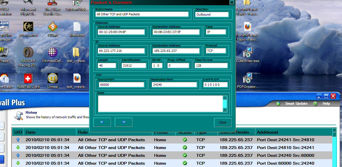

jgf Posted February 10, 2010 Share Posted February 10, 2010 (edited) A quick check just now got this, details are for the third entry in the history window. I've tried to find specific programs associated with this problem, but usually just see "system" or "svchost". Edited February 10, 2010 by jgf (see edit history) Link to comment Share on other sites More sharing options...
