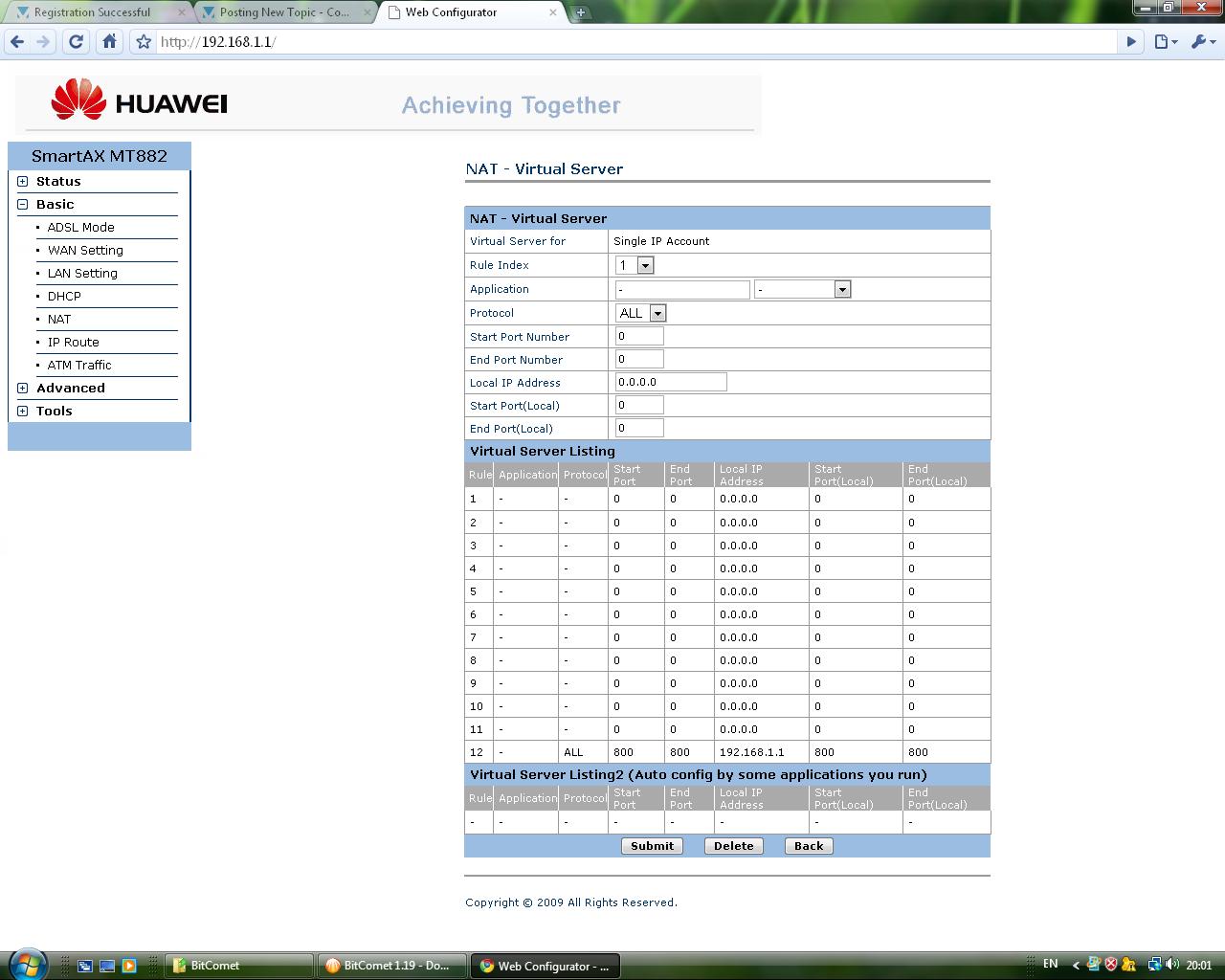

koralon Posted March 9, 2010 Share Posted March 9, 2010 buna ziua, dupa ce am urmat 100 de tutorialuri portul meu e tot yellow acuma am incercat cu portforward problema e ca eu am huawei->smartax mt882 ei pe siteul lor(portforward) sunt 3 variante de modem ca asta nici unu nu se potriveste... am reusit eu sa ma duc la nat-> etc unde tre setat dar nu stiu sa setez :( am pus un screenshoot cu web configurator la pagina cu pricina... daca m-ati ajuta v-as fi recunoscator p.s folosesc bitcomet 1.19 si (nu stiu daca e relevant) dar internet de la romtelecom(clicknet)... -.- Good afternoon, after following 100 tutorials, my listen port is still yellow, I have tried portforward, the problem is that I have a huawei->smartax mt882, there are 3 modem versions like this on their site (portforward), none of them match... I have succeeded in going to NAT-> etc where I must adujst the settings, but I don't know how to set it. I added a screenshot with the UI at that page, I'll be grateful if you help me. P.S. I use BitComet 1.19 and (I don't know if this is relevant) my ISP is Romtelecom(clicknet) Link to comment Share on other sites More sharing options...

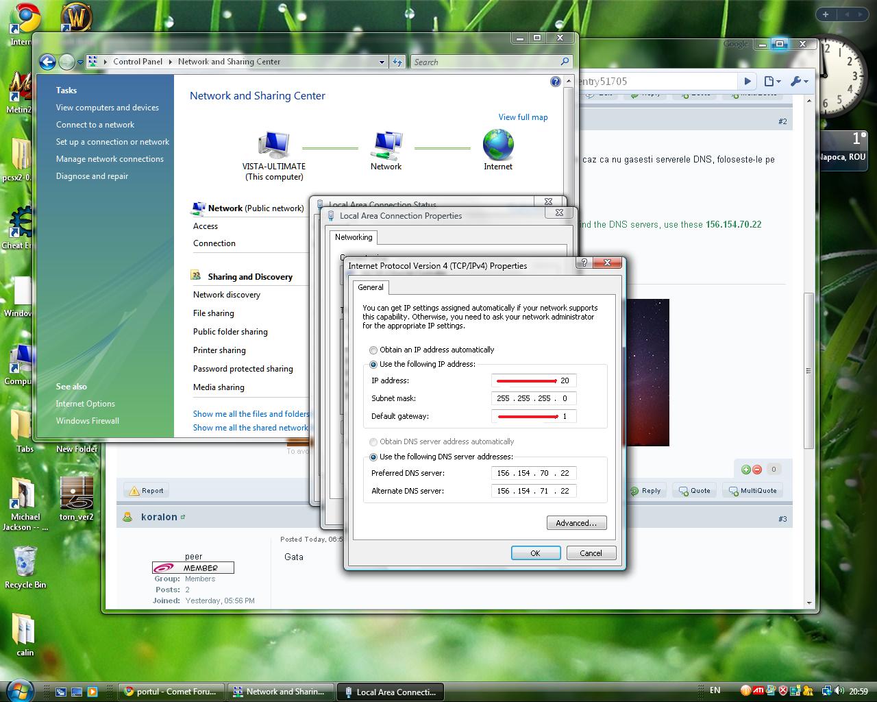

koralon Posted March 10, 2010 Author Share Posted March 10, 2010 Gata am pus un screenshot... (am facut in asa fel incat sa nu se vada primele cifre de la ip respectiv gateway) Done I added a screenshot... (I smudged the first numbers of the IP and Gateway) Link to comment Share on other sites More sharing options...
Vasy Posted March 11, 2010 Share Posted March 11, 2010 Bine Acum mergi inapoi la acea pagina din primul screenshot si scrie un nume (oricare, de ex Bitcomet, ca sa stii pentru ce e) in casuta "Application" apoi la protocol lasi pe "ALL", si in toate casutele cu "Start port" si "End port", respectiv local, scrii acelasi numar (peste 50000) si-l tii minte, in casuta "Local IP Address" scrii adresa IP statica din al doilea screenshot. Apesi butonul submit pentru a aplica setarile. Acum portul este deschis in modem, deci mergi in BitComet, in meniul "Options" , in sectiunea "Connection" si scrii numarul pe care l-ai tinut minte mai sus in casuta "listen port" si apesi OK. Lumina trebuie sa se faca verde in cateva secunde. Daca e tot galbena inseamna ca mai ai un firewall in care trebuie sa faci o regula pentru bitcomet. OK Now go back to the page shown in the first screenshot and write a name (any, for example BitComet, to know what it's for) in the "Application" box then leave the protocol set to "ALL", and write the same number (over 50000) in the "Start port" an "End port" , local too, boxes and memorize it, write the static IP address shown in the second screenshot in the "Local IP Address" box. Click the "Submit" button to apply the settings. Now the port is open in the modem, so you need to go in BitComet, "Options", in the "Connection" section and write the number you memorized earlier in the "Listen Port" box and click OK. The light should turn green in a matter of seconds. If it's still yellow then you have another firewall where you need to create a rule for BitComet. Link to comment Share on other sites More sharing options...
koralon Posted March 11, 2010 Author Share Posted March 11, 2010 (edited) Pai dupa aia unde scriu bitcomet este o chestie in care tre sa aleg mai multe chestii "fph, pptp etc." care o aleg? The box where I have to write "BitComet" is only letting me choose between some options like "fph, pptp, etc" witch one do I choose? Edited March 12, 2010 by Vasy (see edit history) Link to comment Share on other sites More sharing options...
koralon Posted March 11, 2010 Author Share Posted March 11, 2010 (edited) nvm merge! multumesc mult :X nvm it works! Thanks a lot. Edited March 12, 2010 by Vasy (see edit history) Link to comment Share on other sites More sharing options...
