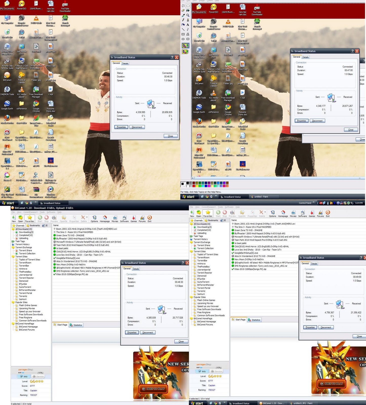

hi I want to say that bit comet uses the bandwidth even I am not downloading anything from the internet like I am showing u the photo which shows my internet connection status of half min with the bitcomet software running and without the bitcomet software running check the difference between the usage of with the bitcomet running and without running see the link for better view of photo http://1.bp.blogspot.com/_DRYLQJDCuRI/S7M5m0Ash2I/AAAAAAAAAoU/P3Tw4t9aI2w/s1600/bitcomt.JPG
It is basically four photo attach to make one the first photo on left above shows the status of my internet connection at 46.30 min the sent bytes is 4339585 and received bytes is 20658935 bytes
2nd shows the status after 30 sec it’s sent is 4348177 and received is 20671267 bytes
The difference is in sent is 8592 and received is 12332 like this bytes does not make any difference to me it’s very less
But in case when I run the bitcomet application without downloading any file or downloading files but blocked by scheduled download by bitcomet the status shows
In the third photo like down left shows the status of my internet connection at 48.30 min the sent bytes is 4385939 and received bytes is 20717526 bytes
Last photo down right shows the status after 30 sec it’s sent is 4756367 and received is 21356422 bytes
The difference is in sent is 370428 and received is 638896 that means its 600 kb download and 400kb upload for no use like 1 mb per half min
I just today left for one hr with the bitcomet software application running and also the internet connection the software download around 100 mb of no use
Plz look into my matter I want that bitcomet doesn’t use any data usage of mine if it is not running any task

well in this case i tried to use wire shark i too much complicated i surppose but i send u all the status i found after the test running normally without any type of application and for 30 sec and running with bitcomet status for 30 sec like now what do u say i have also uploaded the exported files for wire shark download it from here

see the photos for the status

i have already made disable DHT, LT-Seeding, e Mule plugin and Torrent Exchange u can see in the photograph there is no task running

Besides, even in the screenshots you posted, the Status Bar of BitComet shows that DHT is enabled!
