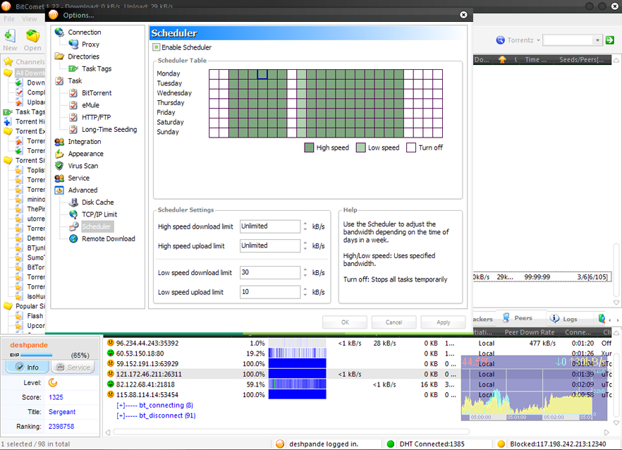

deshpande Posted August 16, 2010 Author Share Posted August 16, 2010 My broadband plan has unlimited download only at night 02:00hrs-08:00hrs so i use scheduler as you can see in the screenshot i have given unlimited (both upload and download) during 02:00hrs-08:00hrs.... Now that i have set both upload and download to unlimited what else can i do to attract normal peer?how can i assure them i am a useful trade.... Link to comment Share on other sites More sharing options...

greywizard Posted August 16, 2010 Share Posted August 16, 2010 You need to limit your max upload to 80% of your tested upload capability to save some band for protocol overhead traffic. Otherwise your client will choke on its own speed. The next equally important thing you should do is to make sure you have an OPEN listen port. Check this guide: I have a yellow status light, and my download speeds are slow. What should I do? Link to comment Share on other sites More sharing options...
kluelos Posted August 16, 2010 Share Posted August 16, 2010 You should set a limit on your upload speed. Every packet you receive must be acknowledged, and you must also upload. During this process, BitCOmet can start to interfere with itself, as acknowledgments waiting in queue time out. You should measure your upstream speed at the times you will be using it, probably at speedtest.net. If you are not going to be otherwise using your network connection, then set your speed limit equal to your actual measured maximum speed. If you plan to use the network for other things, set it to 80% of that maximum. You should strive to assure that each of your tasks is receiving at least 8 KB/s of upload speed, and preferably more. If your speed drops below that, you may be running too many tasks at once. Most connections can only support one seeding task and one or two downloading tasks at once. If your upload speed drops on a task, you become a less desirable connection, so your download speed will probably drop too. Link to comment Share on other sites More sharing options...

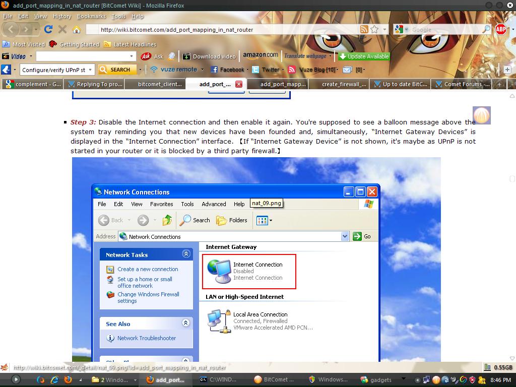

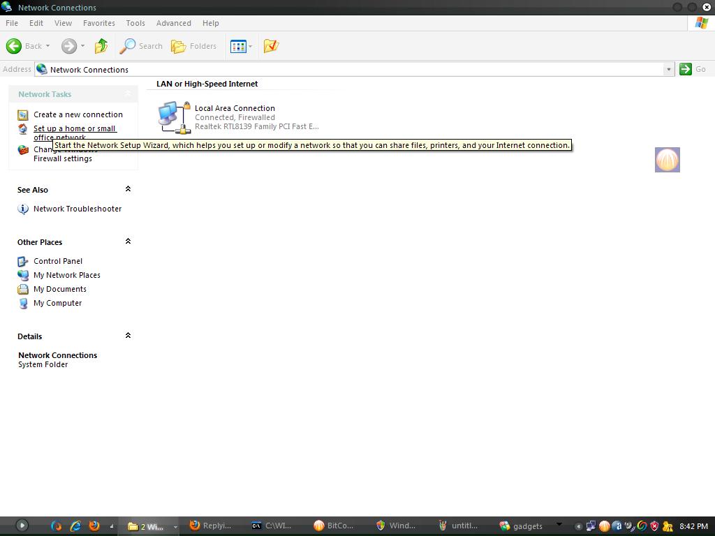

deshpande Posted August 16, 2010 Author Share Posted August 16, 2010 I am unable to open listen port....i did everything right till step 3 in "Configure/verify UPnP status at Windows UPnP panel".In network connection i only see LAN or High-speed internet icon(screenshot) and not that given in step 3(other screenshot).so please suggest wat to do next... Link to comment Share on other sites More sharing options...
