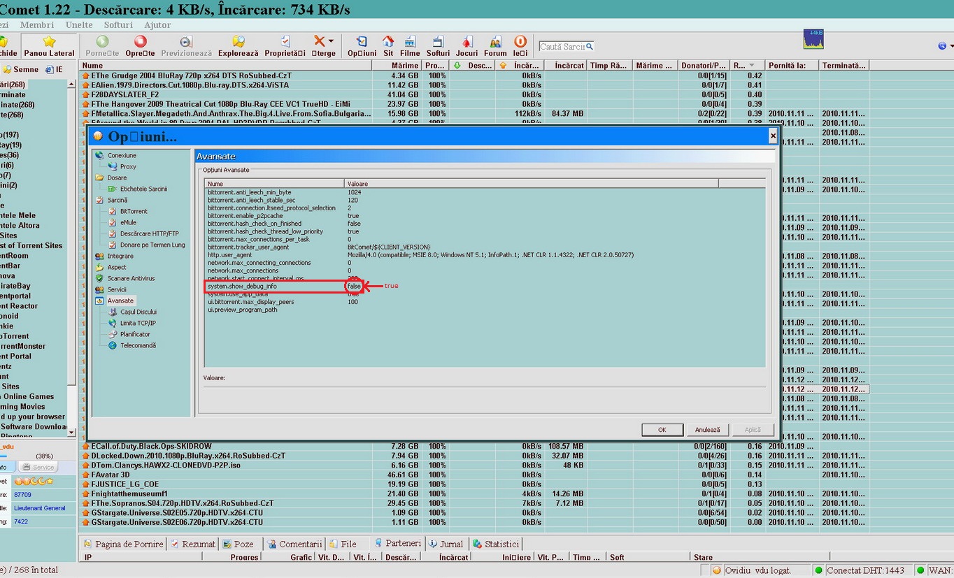

2. a aparut alta problema, viteza de down a fost intotdeauna ok. Ma intereseaza f mult viteza de upload. De ex, imi arata in bara 1000kb/s, iar daca adun toate sarcinile, nu fac mai mult de 500kb/s. Poate este normal si nu am remarcat eu inainte, dar concret, de la 100 gb/upload (media zilnica) am scazut la jumatate in ultimele zile. Banuiesc ca e o setare dar nu stiu care, am incercat mai multe variante (inclusiv de versiune, de la 0.70 pana la ultima 1.23) Atasez pagina cu obtiuni avansate, poate ma ajutati cu o idee.

2. Now I have another problem, the download speed was always OK. I'm more interested in my upload speed. For ex., the title bar shows 1000kB/s, and if I make a sum of the upload speed of all tasks I don't get more than 500kB/s. Maybe this is normal and I haven't noticed this before. But as I can see, the amount I upload daily decreased from 100GB to half of that in the past few days. I suspect that there's a setting that I don't know of. I tried many changes (including other versions, from 0.70 to the latest, 1.23) I'm attaching a screenshot with my advanced settings, maybe you could help me with an idea.

Viteza de incarcare aratata in bara de titlu e suma tuturor transferurilor prin toate protocoalele din BitComet (HTTP, BitTorrent, LTseed, eMule) plus overhead. In cele mai multe cazuri viteza in exces e cauzata de LT seeding, daca e activat. Un protocol nou, detinut de BitComet, conceput pentru a ajuta la transferurile BitTorrent, folosid latimea de banda libera, lasand loc pentru BitTorrent cand e nevoie. Pentru a vedea ce sarcina incarca prin acest protocol, si la ce viteza, schimba in optiunile avansate aratate de tine mai sus , apoi mergi in lista de sarcini si vezi noua coloana, LTseeding.

The upload speed shown in the title bar shows the sum of the speeds of all transfers via all the protocols BitComet uses (HTTP, BitTorrent, LTseed, eMule) plus overhead. In most cases the excess upload speed is caused by LtSeeding, if it's turned on. It's a new protocol, owned by BitComet, made to help BitTorrent transfers, using the free bandwidthit can get, making room for BitTorrent when it's needed. To see which task is uploading via this protocol, and at what speed, change system.show_debug_info, in the advanced settings shown above, from False to True, then go to your task list and see the new column, LT seeding.

Ti-am incercuit in poza data de tine intr-un post de mai sus ce ai de schimbat. Apoi dai click dreapta pe un titlu de coloana din listade sarcini si activezi coloana LTseeding

I marked what you have to change in the picture you attached to a post above. After that right click the header of a column in the task list and then activate the LTseeding column.

Am inteles. Nu-mi dadeam seama de la ce vine LT. Am avut intotdeauna activat LT. Vrei sa spui ca trebuie oprit? Poza nu mai apare la post.
Gata, am vazut poza acuma....o sa incerc si revin. Ii dau un restart?

I understand. I just didn't know what LT stands for. I've always had LT activated. Are you saying that I should disable it? The picture doesn't appear in my post anymore.
Never mind, I see the picture now.....I'll try it and come back later. Should I restart it?
