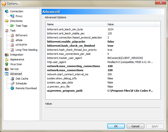

In the advanced options of BitComet, I set network.max_connecting_connections to 100 and network.max_connections to 100 either.

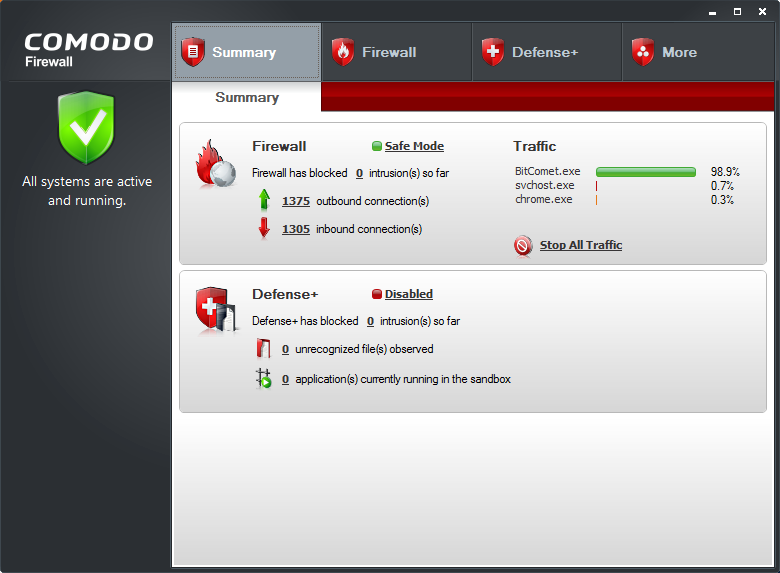

So, I went to look the Comodo Firewall, to see what is going on with my connection, and for my surprise, there are thousands of BitComet connections, inbound and outbound.
If I set the limit to 100, as least theses numbers shouldn't be around thousands.
Attached are the screenshots showing the total of connections in my Windows, and the advanced configuration of BitComet.
Note that, closing BitComet, the total connection drops to 3... maybe 4, so yes, these thousands connections are from BitComet (even looking at the connection list there are lots of bitcomet tcp/udp connections).

You allow 100 connections to be started every second and then you ask yourself why so many are started? :huh:
While I had windows XP, I had the limit set to 8. I had no problems reaching my connection's maximum bandwidth.
Now I have windows 7 32bit, the limit is set to 0(automatic) and I see speeds above 10mB/s (up/down) quite often.
Bottom line? It has no effect on your speed.
Windows vista sp1 (I think) and above don't have the maximum connections/second limit and have a dynamic way of handling that limit. Messing with that limit in windows 7 is a very bad idea.
Give it a try, set it to 0, let it run for a while and see if you encounter any problems.

The network.max_connections parameter acts on and limits the number of TCP connections, that the client can have opened at any time.
However, if you'll look in Comodo at the connections page, you'll see that more than 80% of the "connections" are on UDP protocol (which is being used mainly by DHT). UDP is a connectionless protocol, therefore this doesn't place such a big stress on your PC as it would if these were TCP connections. However, your software firewall and your router will often regard any pair of sockets communicating, as a "connection" regardless if it's using TCP or UDP as a transport protocol.
That's because, sockets that communicate occupy entries in the internal tables of those respective entities (e.g. in the NAT table of the router). For some router models this can probably lead to exhausting the memory allocated to the NAT table and to issues of this type.
I've requested too, a while ago an option to limit the max number of simultaneous UDP transmissions incoming and outgoing, just to be able to troubleshoot this type of issue, but I'm not sure how easy it is to implement for the team.
