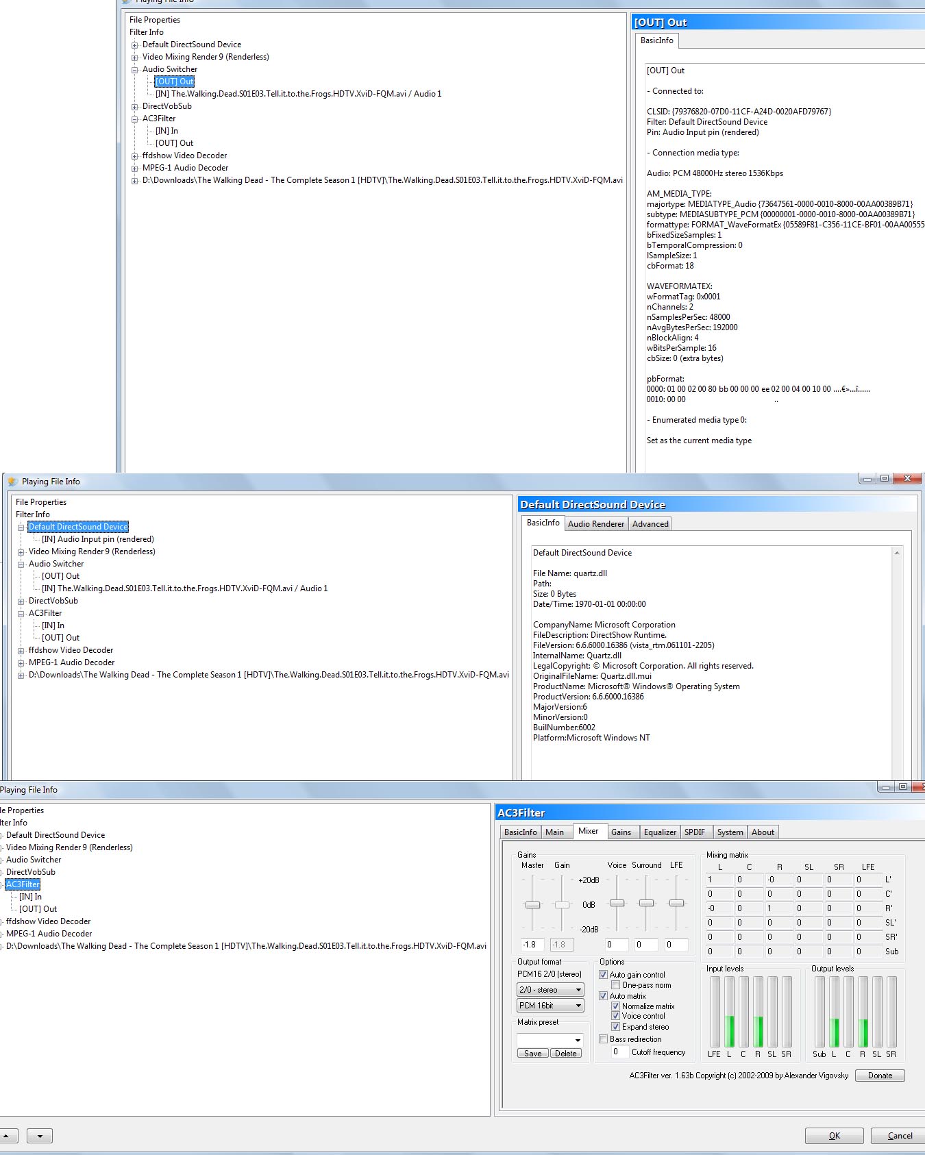

kluelos Posted April 8, 2011 Share Posted April 8, 2011 Well, it's fairly simple. You look at what are called "failure modes", which is to say, "how can this system fail?, and how can it not fail?" For example, an automobile's brakes can fail for many reasons, but getting motor oil from the engine into the brake lines isn't one of them. That just isn't ever going to happen except under truly bizarre circumstances. So you cross that off your list of likely causes of brake failure. Now since MPCStar/TigerPlayer depends on external filters to decode sound, it's not likely that they would all fail at once and forever. Rather it's much more likely that MPCStar finds itself isolated from the correct sound output device. It's playing, but to the wrong thing, or to nothing, or it has been muted as an input source. That is something that could happen suddenly and could affect all sound output. These are all system issues. Now if you'll do some exploring under File Info, you'll notice that MPCStar constructs a "chain" of virtual devices for each file it tries to play. What the chain consists of depends on the file. This is where you can begin to explore what isn't working, or what's inappropriate. It's also where you'll see error messages or indications. It is also probably where you should have looked first, since the next thing anyone trying to help is going to ask is, "what does File Info say?" Link to comment Share on other sites More sharing options...

Nitzan Posted April 10, 2011 Share Posted April 10, 2011 Well, i look in the "FILE INFO" and i dont know what exactly im looking for. There are no "errors" as far as i can tell. Actually in the AC3Filter -> Mixer i can see the Right&Left bars going up and down like there is a sound playing. Can you please guide me what to look for? given the facts i just told you... Link to comment Share on other sites More sharing options...
kluelos Posted April 11, 2011 Share Posted April 11, 2011 That's a good indication. You have a signal coming out of the filter and going into the mixer. Now you need to follow the signal forward, seeing what's coming out of the mixer and where it's supposed to be going from there. The reverse chain, starting at the bottom, should end up in a virtual (or actual) sound device that's in your system. On mine, for example, with nothing but the mainboard sound installed, it ends up in the default DirectSound device. It's up to DirectSound after that, and DirectSound has its own test routines built in as a part of dxdiag. That part is probably working fine, if you can hear everything else, so likely the signal is never getting to DirectSound, or is getting muted along the way. Where you check or correct that depends on your OS. Now you may be able to fix whatever it was that happened, by completely uninstalling MPCStar, rebooting, then reinstalling from scratch, which is at least more straightforward than trying to trace the audio signal, so if you dislike poking into the odd corners of your system, you may want to try that first. Link to comment Share on other sites More sharing options...
Nitzan Posted April 11, 2011 Share Posted April 11, 2011 Hi, I Uninstalled MPC, restarted and installed it again.(version 5). it didn't help :( i did look for any muted devices in my system and they all looked OK. Any other clues you can provide? maybe a log of some kind that can help you help me? I Attached a screen capture,maybe it will help. (btw, DirectX 11 is installed) Thanks. Link to comment Share on other sites More sharing options...
