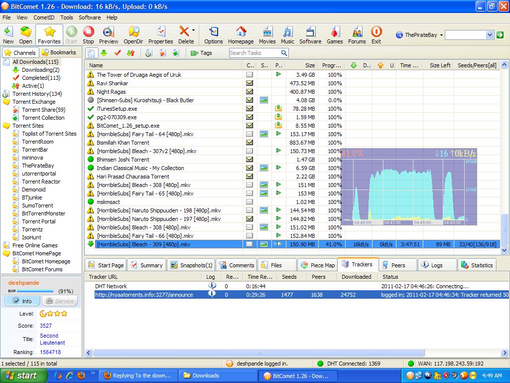

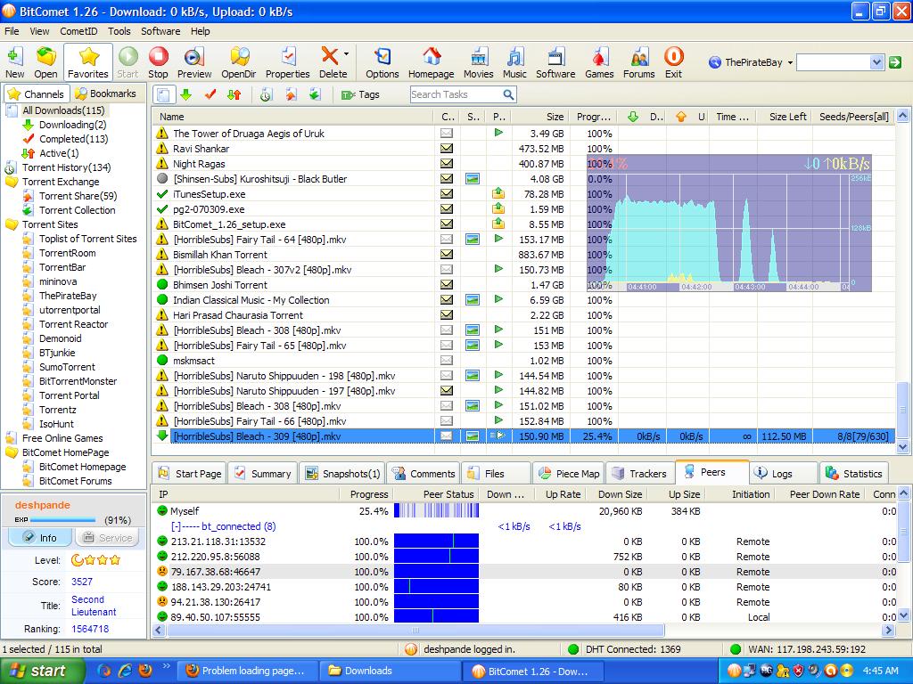

deshpande Posted February 18, 2011 Author Share Posted February 18, 2011 ya, sorry in one of my previous post i had uploaded same screen shot many times one after the other....my mistake but that was not on purpose. After i posted that reply i tried to delete the unwanted repeated screen shot but i couldn't...thanks for deleting. Anyway coming to the problem: the connection is there & i have net access ....the DHT is connected,listen port open. May be as you said upload speed could be the problem as it was only 2KBps,but still if most of the peers connected are seed and also there lots of LT seeds then this is bound to happen. i added 2 screen shots. You can see clearly in the screen shot The floating window how the download increases and drops continuously also in one shot there just 8 peers and the other has 40 peers. Link to comment Share on other sites More sharing options...
kluelos Posted February 18, 2011 Share Posted February 18, 2011 Hmm. In both of those torrents, your upload speed is zero. However that came about, it makes you a very undesirable trade partner, which would soon bring your download speed to near zero as peers decide not to spend any more bandwidth on you. So the question becomess, why is your upload speed zero? Link to comment Share on other sites More sharing options...
deshpande Posted February 18, 2011 Author Share Posted February 18, 2011 ya, i agree....if you see the floating window carefully the upload has been taking place in small patches and also amount of upload is very less. I have set the upload speed to unlimited and downloaded the similar(not same though) content from another website still the same thing happens. Link to comment Share on other sites More sharing options...
