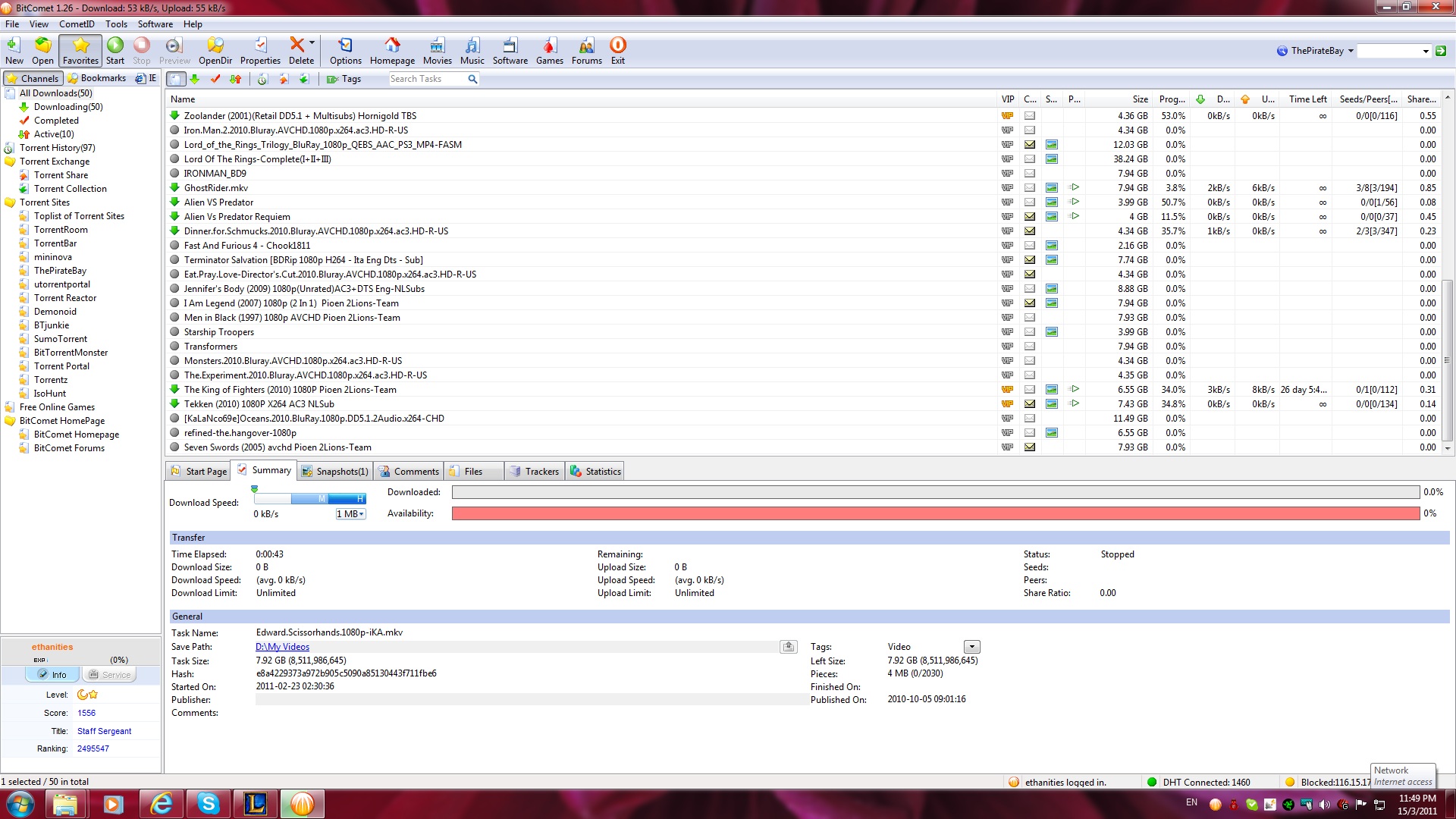

ethanities Posted March 16, 2011 Author Share Posted March 16, 2011 At SPEEDTEST DL: 16.86Mb/s UL: 0.85Mb/s And after waiting so long an patiently trying this service. I truly have yet seen it working on my downloads. Sigh. Attached a picture of my current dl. Note that I have left this dl on for 3 days. I have tested with just only a single dl as well. Link to comment Share on other sites More sharing options...
voxsiever Posted March 16, 2011 Share Posted March 16, 2011 Not a pro by any means, but Im thinking that perhaps the lil yellow ball next to WAN (lower right hand section of BitComet) just maybe might have something to do with your issue? I think it represents the status of your listening port.. http://wiki.bitcomet.com/Frequently_Asked_Questions#configuration_and_user_settings Link to comment Share on other sites More sharing options...
ethanities Posted March 16, 2011 Author Share Posted March 16, 2011 What would you advice I modify then? At times I have been able to dl up to 1500 kB/s so I always thought I was configured right as well. Thank you bro! Link to comment Share on other sites More sharing options...

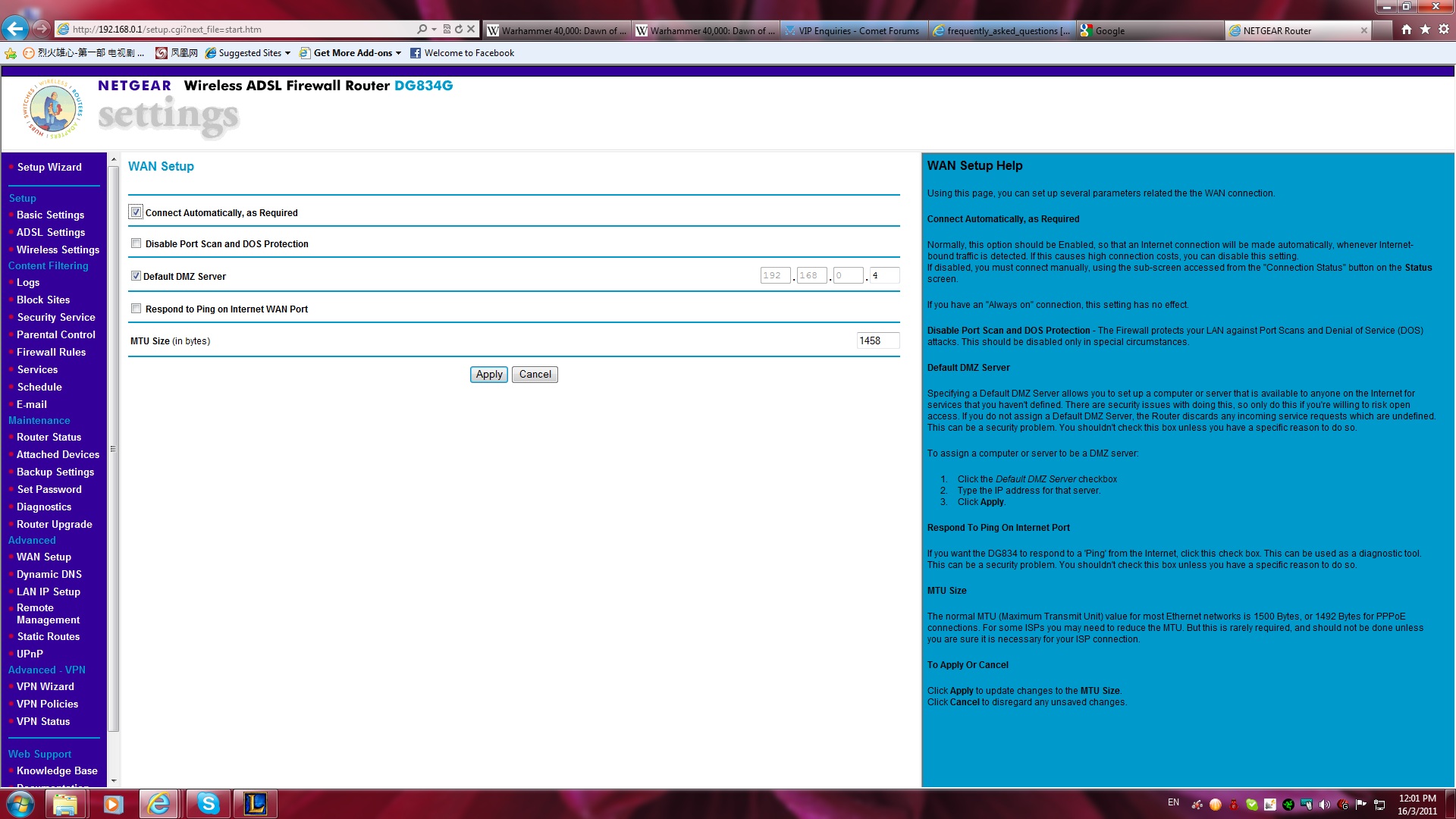

ethanities Posted March 16, 2011 Author Share Posted March 16, 2011 I have set my ip right. Is there anything else? Link to comment Share on other sites More sharing options...
ethanities Posted March 16, 2011 Author Share Posted March 16, 2011 Forgot to attach Link to comment Share on other sites More sharing options...
greywizard Posted March 16, 2011 Share Posted March 16, 2011 There is a detailed guide for port-forwarding in the Wiki, which covers both alternative port-forwarding methods: automatic and manual. You can find it here: Add Port Mapping in NAT Router Link to comment Share on other sites More sharing options...
kluelos Posted March 17, 2011 Share Posted March 17, 2011 You're running far more tasks than your connection can support. With that small upstream speed you probably can't do more than one seeding and one downloading task. Take a look at your upstream speeds for those active torrents. 2 or 3 KB/s makes you a pretty unattractive peer, so you're only going to get similarly unattractive partners most of the time. Given that you haven't opened your listen port, it seems likely you haven't configured your client either, and that would further slow you down, inhibiting all communication including VIP downloading. You really need to sort your client first. Link to comment Share on other sites More sharing options...
The UnUsual Suspect Posted March 17, 2011 Share Posted March 17, 2011 For starters, definitely reduce the number of tasks. If you don't, all your tasks will run slow. As you experienced, you may sometimes come across some very strong torrents that will have more people uploading then downloading, and in that case, you will get data from the peers that you haven't earned, but in most cases, you won't get any good peer connections. If a peer offers to trade with you and sends you some data, and waits for the data you promised, and waits some more... keeps on waiting, then eventually gets it elsewhere, then when you finally do send it, it's ignored, as are any future requests you send that peer. Since your maximum upload speed is 0.85mb/s, or 850kb/s, which when converted from bits to Bytes equals about 106kB/s. On an average torrent with all peers equal, you can expect to upload at about 85kB/s and download at about the same rate. This does make you an ideal candidate for VIP. You can only upload at 85kB/s but the vip servers can upload hundreds of times faster, so as long as there are peers to supply the data, they will get it much faster and send it to you. One of the major problems is obviously the blocked listening port, but also your going to want to enter a global max upload rate limit of about 85kB/s. If you don't do this, then bitcomet might use all your upload of 106kB/s to send data, then anyone trying to trade with you will get no response. When you impose this limit, and open your listening port, your performance will improve. From there you'll have to change your download habits too. When you run less tasks, you'll get better performance on them and download faster over all, and most important you'll become a good peer, one that others are eager to connect to. Link to comment Share on other sites More sharing options...
