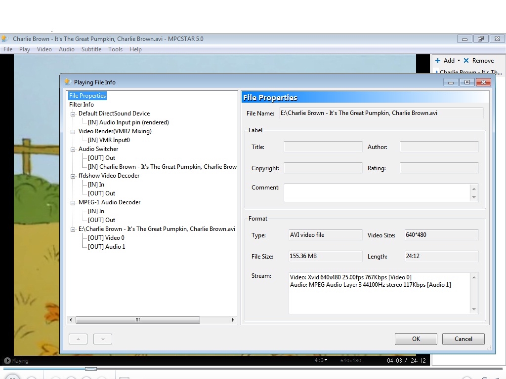

Lucy26 Posted March 21, 2011 Share Posted March 21, 2011 Hi jahiiiwolf, please play the file which had problem, then press Ctrl+I, the "Playing File Info" window will pop up, please take a screenshot of that window and put it here. Link to comment Share on other sites More sharing options...
jahiiiwolf Posted March 21, 2011 Author Share Posted March 21, 2011 (edited) grey- I uploaded the following files to my web space. http://lbd9.tripod.com/MOV01122.AVI It is 5MB, and 14 seconds at 320x240. The audio is poor quality but that is the recording not the player. The audio on other files was played at perfect quality. DUE TO TRIPOD RULE THIS LINK WILL NOT WORK. THE URL IS GOOD THOUGH. Suspect- All the internal codecs that came with the MPC Star (minus the rat DVDs). I prefer ffdshow myself. The only other thing I found was a Dolby AC3 codec that I found online before I got MPC Star, but that is an audio codec. Windows media player may have come with some codecs, but I would not know which one or where to find a list. Lucy- This is a different file, but has the same problem. You will notice that, since I have file info open, the video is showing as I indicated in my initial post. (It is real blurry but that is because I recorded this with my digital camera, and was in a unsteady position.) Edit: Tripod won't let me post the image to here but the address for it is: http://lbd9.tripod.com/temp.jpg DUE TO TRIPOD RULE THIS LINK WILL NOT WORK. THE URL IS GOOD THOUGH. Edited March 21, 2011 by jahiiiwolf (see edit history) Link to comment Share on other sites More sharing options...

Lucy26 Posted March 21, 2011 Share Posted March 21, 2011 Hi jahiiiwolf, the image I need is actually the left side of the file info window. I'm not able to view the image in that URL, can you please upload the picture in the post? please read How to add a screenshot to your post (simplified version). Link to comment Share on other sites More sharing options...
jahiiiwolf Posted March 21, 2011 Author Share Posted March 21, 2011 I don't know why. I know the link does not work but when the URL is manually entered or copied and paste it works just fine. I will try to add it to this post (and this will be a different file, since this is not my only media viewing computer and I need to copy each file onto his computer's tiny hard drive file by file, but the same thing happen every time.) Link to comment Share on other sites More sharing options...

The UnUsual Suspect Posted March 22, 2011 Share Posted March 22, 2011 The posted screenshot is from a different video, the initial screenshot didn't show all of the data that Lucy wanted, so he made a new one, but it did show the video stream as Mjpg, not Xvid. The most recent screenshot is of an Xvid stream. Since both have the same issue, and we know that mpcstar can play them, it makes me think there are conflicting codecs. Link to comment Share on other sites More sharing options...
