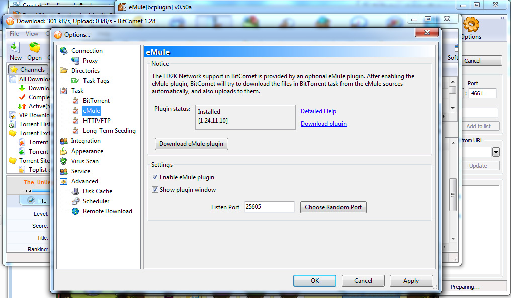

The UnUsual Suspect Posted July 12, 2011 Share Posted July 12, 2011 Strangely enough, when I tried to use the 1.24 eMule plugin with BitComet 1.28, BitComet complains that the plugin is "out-of-date" and refuses to recognise it... I just installed emule plugin 1.24 on bitcomet 1.28 and got no such message. Can you try again and provide a screenshot if you get the message? Link to comment Share on other sites More sharing options...
panickety Posted July 12, 2011 Author Share Posted July 12, 2011 Okay, this is embarassing... you're right, of course. The error message I described earlier was for plugin 1.19. When I go to BitComet's Options->eMule and hit the "Download eMule Plugin" button, I got 1.19 To get 1.24, I have to go to the BitComet site and download it manually. Sorry about this. Rgds Link to comment Share on other sites More sharing options...
The UnUsual Suspect Posted July 12, 2011 Share Posted July 12, 2011 When I hit the "download emule plugin" button, it opens the download archives at bitcomet.com (same link as in my signature). Edit: When I click the blue link seen above, it opens the web page, when I click the button, it attempts to download the plugin from an http source that doesn't exist. I'll get that looked at. Thanks for reporting it. From there you can select any current or past version of bitcomet and/or plugins. I don't know why it would have directly downloaded an older version for you, but I'm glad you got it to work. Link to comment Share on other sites More sharing options...
