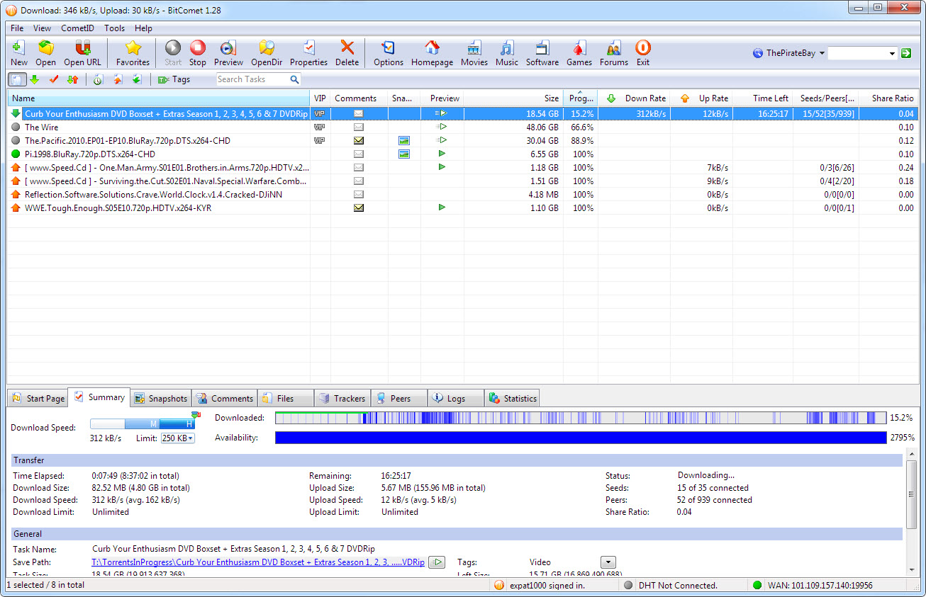

The UnUsual Suspect Posted July 17, 2011 Share Posted July 17, 2011 This was reported before, and it's being looked into. Do me a favor, on your summery tab, hover over the download data on a task that is going over limits and it will show you what the sources are. Take a screenshot of this data while it's going over and I'll submit it to development. For a temp work-a-round, try lowering your limit a bit, see if that helps. If you want an explanation, BitComet is unique in that it can download your data from multiple sources. Other clients only get the data from bittorrent peers, but bitcomet can get the data from LTseed peers, emule peers, http/ftp sources, or even peers of a different torrent with some/all of the same data. This is actually much more complicated then it sounds and these features have been added and debugged since version 0.71. For the most part they are stable, but it does create some unique issues, like tracking and controlling speeds from all these sources. If you disable all these advanced features, then it will control the speed more accurately, but it won't perform any better then any other bittorrent client. Link to comment Share on other sites More sharing options...
expat1000 Posted July 17, 2011 Author Share Posted July 17, 2011 Thanks for the quick and detailed response. I have not seen it happen from only one source, but will play around and if I can make it do that, will upload the screen shot. I am a long term utorrent user, but I found the last few versions, or perhaps it is a Windows 7 issue with utorrent, - anyway it ate a lot of CPU cycles and hung all the time. I am sort of happy about that now as it forced me to look around for an alternative and Bitcomet has a nicer interface, more features, and downloads faster. Ah, now it is over speed - here is the screenshot. Link to comment Share on other sites More sharing options...
