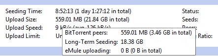

sharayde Posted July 22, 2011 Author Share Posted July 22, 2011 Excellent, that does exactly what I asked for :-) Only thing is that it now makes me realise that it would also be nice to have another column for session upload size for those tasks where the LT seeding rate varies a lot or only happens in short bursts. Another reason for this is that BitComet often reports a much larger upload size than my router. I reset the router and my PC the other night and in the morning the router reported 3.5GB sent but BitComet reckoned nearly 8GB had been uploaded. Does BitComet record the full size of data if the upload is compressed as it goes? Link to comment Share on other sites More sharing options...
greywizard Posted July 22, 2011 Share Posted July 22, 2011 The per session upload size you can find by hovering the mouse over the Upload Size and Download Size, in the Summary tab, for each task. You'll find the data divided by protocol. The data in front of the parenthesis is the data for the current session while the data inside parenthesis is the data for all sessions since that task was added to the list (global data). I doubt that the team will consider moving that into columns (it would require 6 columns to cover upload and download for all 3 protocols) since it would further clutter an already full pane. As for your router, there isn't much I can tell you from here (possibly not even while in front of your router). Short of knowing exactly WHAT data your router counts, there isn't much sense in comparing the two values. We know for a fact that BitComet will count data transferred for both transport protocols it uses (UDP and TCP). If you can confirm that your router does the same then you can start observing and comparing the two values. But in case your router counts only data transferred by TCP then the comparison is pointless. AFAIK there is no compression involved in the proprietary LT-Seeding protocol and the other two (BitTorrent and eDonkey) would have to specify compression negotiation methods and compression alogrithms IN the protocol specifications, in order to be able use it in peer-to-peer connections. BitTorrent doesn't include that and as far as I can remember neither does eDonkey. Link to comment Share on other sites More sharing options...
sharayde Posted July 25, 2011 Author Share Posted July 25, 2011 Hi, There is no 'per session' size displayed for LT seeding when you hover over the upload and download values on the summary page, it is only displayed for BitTorrent peers or eMule. Link to comment Share on other sites More sharing options...

sharayde Posted July 27, 2011 Author Share Posted July 27, 2011 Sorry, my fault, it is fine for LT Download, I was looking at LT Upload, where it isn't displayed :-) Link to comment Share on other sites More sharing options...
