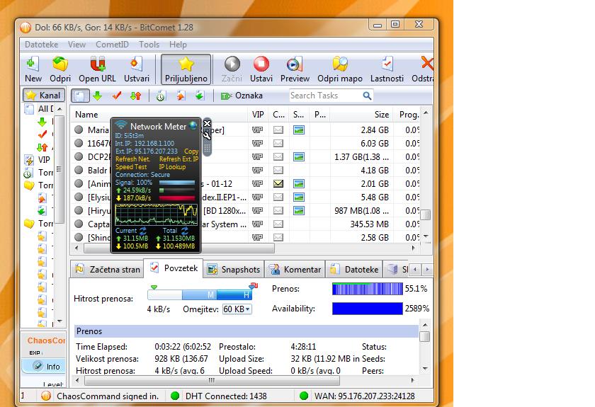

chaoscommand Posted August 5, 2011 Author Share Posted August 5, 2011 Hello, Bitcomet itself shows no significant traffic over the limit, but netmeter says something different, as seen in attachment. I hope i'm hovering over the correct stat, but on other hand, every one of them shows the same. btw, i noticed that net meter scale is missing, it spans 0-180 kB/s. No other programs were running when print screen was taken, for further reference... After reinstalling twice more (current and also print screen state), it's not so obvious anymore, before it was just a bit saw-like around 160 kB/s compared to shown in attachement. Judging from the bitcomet installer, could it be that installed files are not actually checked? Meaning it believes windows saying all files OK and makes no hash cheks? It seems as if something was corrupt when extracting (with the instaler), and a single reinstall didn't help (had to do 4 for effect, but it's still not perfect) Link to comment Share on other sites More sharing options...
The UnUsual Suspect Posted August 5, 2011 Share Posted August 5, 2011 I suspect the difference between the two is the method of measuring. Your netmeter program shows spikes that are high, assuming they are accurate, they still don't account for bandwidth usage at that level. BitComet (correctly) attemps to average your bandwidth to the guidelines you set, but if you were to look at the raw data, you'd see it higher one instance, lower the next... this is unavoidable. I think to get an accurate test to determine if bitcomet's readings were accurate you'd need a program that shows average speed, not peak speeds. Link to comment Share on other sites More sharing options...

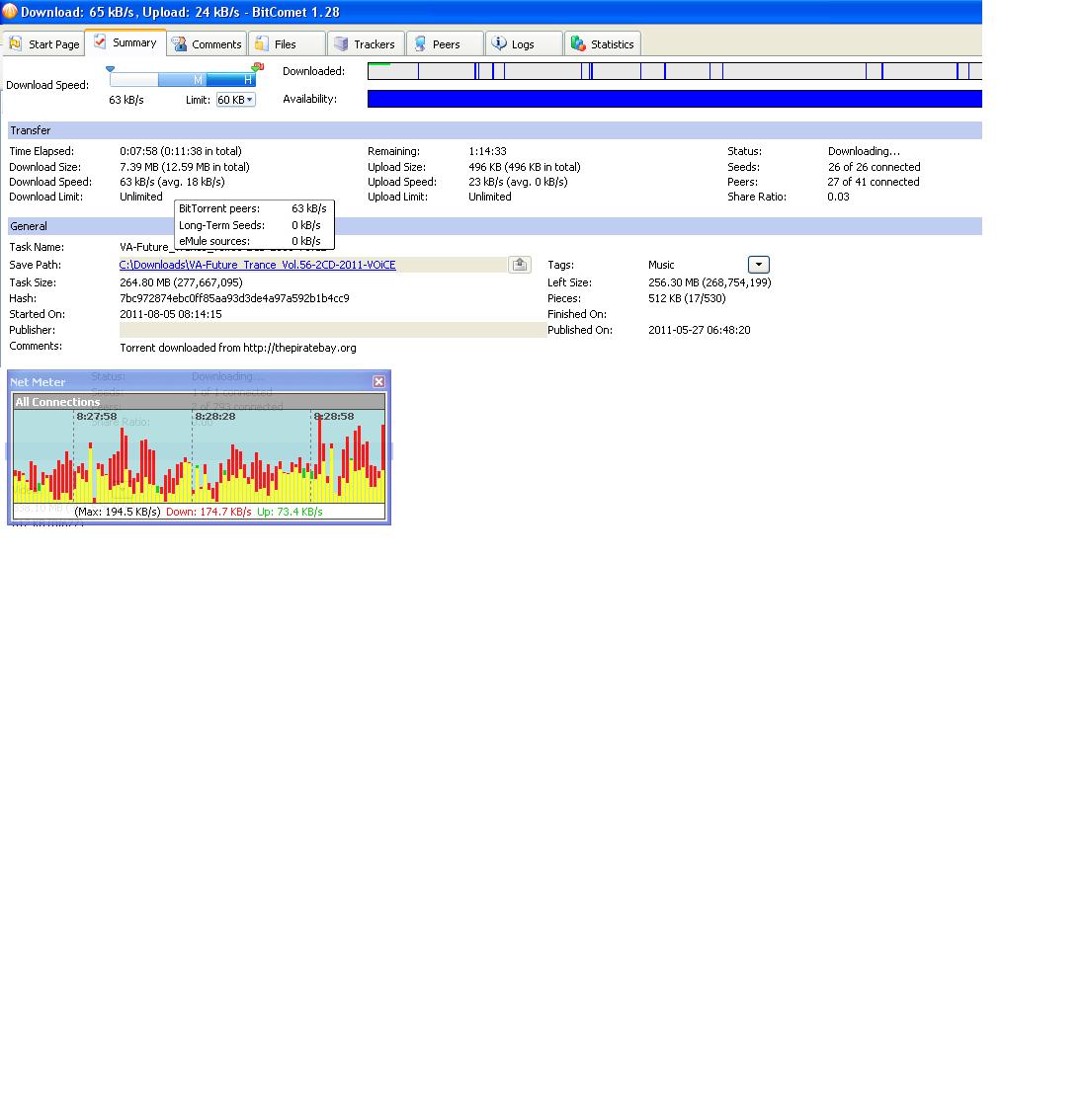

chaoscommand Posted August 5, 2011 Author Share Posted August 5, 2011 (edited) there, finnaly managed to catch it in the act yellow graph is download, and it's constant this time (scale is 0~217 [on auto, so it has to be equal or higher than 187.0] , also time scale is 5s for ech line meaning the whole graph spans one minute). Don't know why upload only hits 25, though. Summary tab hovering again shows only bit transfer, so no eMule or LTseed and is same as seen in window name Edited August 5, 2011 by chaoscommand (see edit history) Link to comment Share on other sites More sharing options...
The UnUsual Suspect Posted August 5, 2011 Share Posted August 5, 2011 If I was convinced that this netmeter results are accurate (which I'm not), then the first thing I'd look for is something else that could be using your bandwidth besides bitcomet. Don't know why upload only hits 25, though. If you shut down everything that uses the net, then go to speedtest.net and run some tests, you'll probably find your upload speed is much slower then download. Most connections are. Also, there have been countless examples of users running bitcomet on limited connections where it consumes all available bandwidth, and BitComet's display has never been shown to be inaccurate. If it used twice (or more) then it displays, then this forum would be filled with user reports from the 2.5 million users daily, but so far, your's is the only one I've ever seen reporting this, so I have to question your data. Perhaps you could look for another program that monitors bandwidth and see if it supports this netmeter's results, but to be accurate, you'd need a program that could identify only bitcomet's usage, you could have any number of processes that are using bandwidth. Link to comment Share on other sites More sharing options...

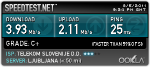

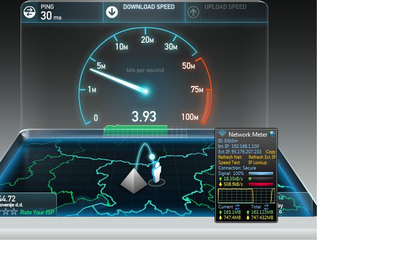

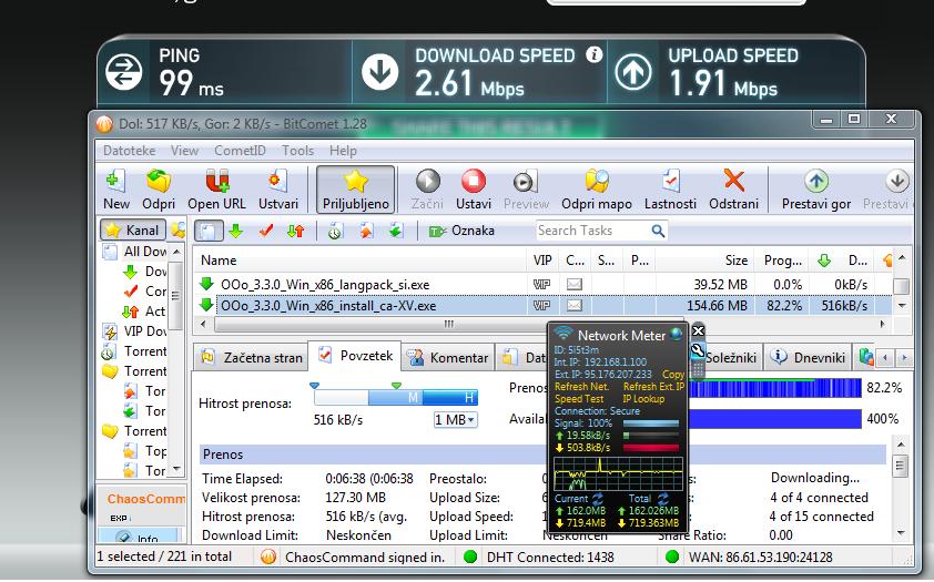

The UnUsual Suspect Posted August 5, 2011 Share Posted August 5, 2011 According to your test, you have a maximum download speed of about 490kB/s. Let's try an experiment, download a torrent from openoffice.org here. Set bitcomet's download limit to unlimited and run the torrent. With nothing else using your bandwidth, you should see bitcomet using most of your 490kB/s (probably about 450), and if netmeter reports higher, then you know it's faulty. On the other hand, if netmeter reports 490 and bitcomet reports much less, then this may require further research. Save screenshots of the process in case we need to alert development of any potential problems. Link to comment Share on other sites More sharing options...
chaoscommand Posted August 5, 2011 Author Share Posted August 5, 2011 (edited) did as told with bitcomet running I'm intrigued... how does this show anything? speedtest got slower results as bitcomet was using bandwidth, right? also, bitcomet shows higher speeds than net meter. (3.93 mbps=503.04kilobyte per second) so bitcomet shows wrong values here (you claim it's accurate?). now, just for my info, i started speedtest without bitcomet running (to get actual download speed) and watched the net meter. netmeter was off by 5 kBps wich i deem within the tolerance area. also, i think this has nothing to do with my issue that is, bitcomet uses up 3 times more bandwidth than what it shows Edited August 5, 2011 by chaoscommand (see edit history) Link to comment Share on other sites More sharing options...
The UnUsual Suspect Posted August 5, 2011 Share Posted August 5, 2011 Your tests show that bitcomet is using as much of your bandwidth as possible on the openoffice torrent, slightly higher then the speedtest indicated, clearly showing the speedtest was conservative, but this isn't unexpected. What it does show is that the amount of bandwidth bitcomet reports is accurate. If it was reporting less then it uses, then it wouldn't be reporting 517kB/s, since we know that this is approximately the max your isp will allow. bitcomet uses up 3 times more bandwidth than what it shows This is not supported by the facts. BitComet is showing that it is using 517kB/s at the moment of the screenshot. This is about a normal peak usage for a 4mbit broadband connection. Your speedtest proves bitcomet cannot be using more. Link to comment Share on other sites More sharing options...
chaoscommand Posted August 5, 2011 Author Share Posted August 5, 2011 (edited) err, i can't argue on this one BUT this test right now (thought it was to determine if either network meter or bitcomet is wrong..) was made with no global limit, so naturally the whole line got hoged. If we return to the problem i reported: I set a global limit-> bitcomet task shows speeds equal or lower than the limit, bitcomet floating window, window name show limit+10%(roughly). no problems here. Now, my understanding is, that quite a lot of broadband is still free (bitcomet does show a reasonable value). But my network meter and my intuition say something else. Namely, internet browsing is painfully slow -a fact-, supported by netmeter showing that nothing of the line is left. Shut down bitcomet-> fast browsing, free bandwidth to spare according to netmeter, just as it should be. 517 kB/s equals 4.04, but since 4 is what ISP offers it can't be reached (not with this ISP)and sure as h*** i wasn't waiting for a spike to take the screenshot. but this is not an issue... Now I'm not saying somethings wrong with the UL/DL display, but solely that something in bitcomet uses up my connection even with global limit set. I guess it's not actually torrent traffic, since the actual time needed for downloads is the same as computed for limited speed. for the not supported by facts: of course it's not supported by any fact. I just tried setting limits to different values. Responses were similar, first a spike to top speed possible, then gets steady at about three times limit value (60-> 180, 40->120 etc.) All this has been written in earlier posts Edited August 5, 2011 by chaoscommand (see edit history) Link to comment Share on other sites More sharing options...
