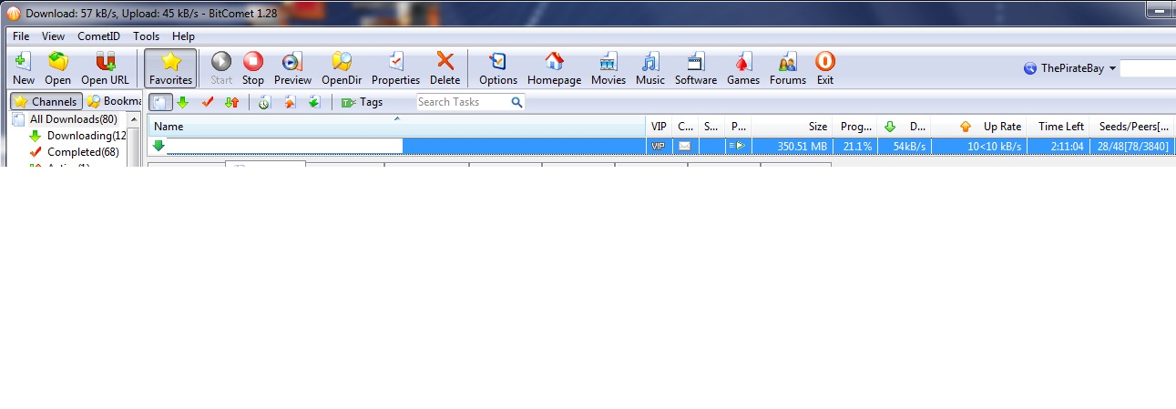

z3rokool420 Posted September 20, 2011 Share Posted September 20, 2011 (edited) what? your post sounds like lies... my "limit" its exceeded MASSIVELY... it doesnt matter what the limit is set to. the upload is maximized and download suffers. i dont mind shareing. but not when i cant download anything..... if upload is set to 10kbps my connection is saturated to maximum (50kbps) if i limit it to 5 its still @ 50kbps. if i limit it to 15 its still maxes my upload. for the last 8 or 9 versions its done this. infact when i turn all tasks off bitcomet maxes my upload. even though i might have all tasks off. only way to bypass the anoyance is to not use bitcomet. utorrent? i dont care i like bitcommet but im done wit my connection being monoplized. its to the point now where the task does what it wants and i cant even download because from the moment "GO" my connection is uploading at max. at work.... at home... for the last year of bitcommet it does this bullshit. before(i moved) i had enough bandwidth now i dont. dont tell me it runs a little bit over. 400kbps over 35kbps isnt "a little bit" infAct i can stop all tasks. and bitcomet will STILL upload at MAX SPEED unless i shut down the program!!!! Edited September 20, 2011 by z3rokool420 (see edit history) Link to comment Share on other sites More sharing options...
z3rokool420 Posted September 20, 2011 Share Posted September 20, 2011 (edited) WHAT the f*** s wrong with this stupid program?!?!?!?!?! is it 44 or 10?? dont tell me 34 over 10 is a "little bit off" and this other one with NO TASKS running.... WHAT THE IS DOING THE UPLOADING?? WHAT NON EXISTANT TASK?? Edited September 20, 2011 by z3rokool420 (see edit history) Link to comment Share on other sites More sharing options...

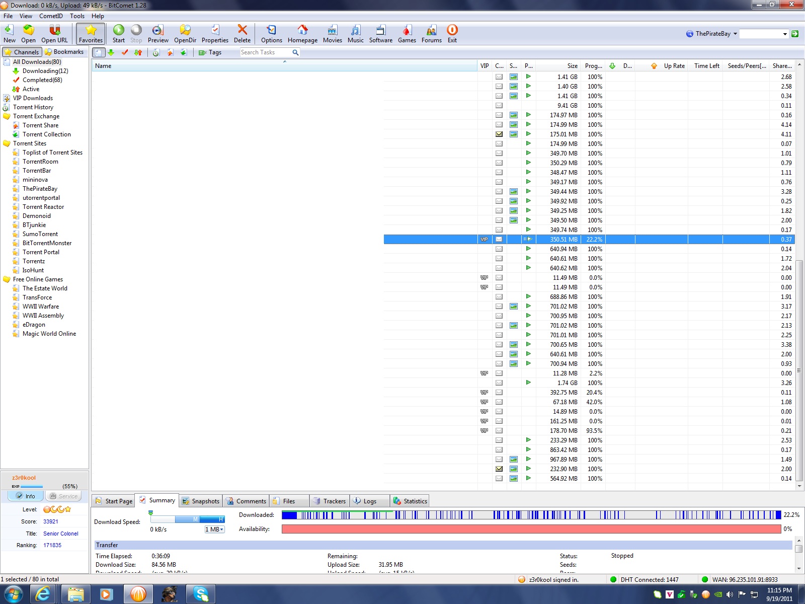

z3rokool420 Posted September 20, 2011 Share Posted September 20, 2011 (edited) max upload with no task running. screen shot!!!!!!!!!!!!!!!!!!!!!!!!!!!!!!!!!!!!!!!!!!!!!!!!!!!!!!!!!!!!!! what non-sence!!!!!!!!!!!!!!!!!!!!!!!!!!!!!!!!!!!!!!!!!!!!!!!!!!!!!!!!!!!!!!!!!!!!!!!!!!!!!!!!!!!!!!!!!!!! Edited September 20, 2011 by z3rokool420 (see edit history) Link to comment Share on other sites More sharing options...
The UnUsual Suspect Posted September 20, 2011 Share Posted September 20, 2011 z3rokool420, Besides being very unwise to be rude to someone you're asking for help, you've also violated forum rules. If this continues, you'll not be welcome to post here. First thing we need you to do is read the "READ THIS before posting" topic, so we'll know something about your system. Then make your own topic, it would be rude to help you within another members topic. Also I'd recommend you read up on the benefits of Long-Term Seed protocol, what it can do to speed up your downloads, the fact that it can be used to finish an unseeded bittorrent task and in turn share with the rest of the bittorrent swarm, and of course that it queues unused upload bandwidth to be used when your not running any torrents, so the uploading when all tasks are stopped is normal when LTseed is enabled. If you don't like it, disable it, but you will reduce the potential speed of your torrents. Link to comment Share on other sites More sharing options...
z3rokool420 Posted September 20, 2011 Share Posted September 20, 2011 z3rokool420, Besides being very unwise to be rude to someone you're asking for help, you've also violated forum rules. If this continues, you'll not be welcome to post here. First thing we need you to do is read the "READ THIS before posting" topic, so we'll know something about your system. Then make your own topic, it would be rude to help you within another members topic. Also I'd recommend you read up on the benefits of Long-Term Seed protocol, what it can do to speed up your downloads, the fact that it can be used to finish an unseeded bittorrent task and in turn share with the rest of the bittorrent swarm, and of course that it queues unused upload bandwidth to be used when your not running any torrents, so the uploading when all tasks are stopped is normal when LTseed is enabled. If you don't like it, disable it, but you will reduce the potential speed of your torrents. i like shareing. but when you use all my bandwidth for LTS and dont let it count on my "sign in" name/VIp? ranked account? whatever what benefit is it to me? there are plenty of terrent clients. not all of them monopolize my bandwidth in a negative way. if you want more poeple to use this client then dont burry settings like that inside submenues with a pre-set limit of unlimited.... i have less then 1.5mbps download and 128kbps upload. your client is great but why would i not be rude? if the client jams my connection...BY DEFAULT! im sorry but thats poor programing. i dont need help. IM GIVING YOU GUYS HELP. you can ban me or delete these posts if you feel, but the point is still there. and i mean no disrespect. i love shareing. my screenshots showed my share ratios. Link to comment Share on other sites More sharing options...
The UnUsual Suspect Posted September 20, 2011 Share Posted September 20, 2011 LTseed doesn't monopolize your connection or bandwidth, the protocol is designed to throttle down when the bandwidth isn't needed for bittorrent transfers, and the benefit to you is even greater for someone with limited upload speed because with bittorrent transfers, you need to gain peers that are interested in trading based solely on what you can send them right now, which in your case is very low, but with LTseed, you can get fullspeeds from each connection, the more you use it, the more connections you're allowed, and in return you will upload to others when your connection isn't being used for bittorrent transfers. If it uses more bandwidth then you like, then change the settings, or if you don't like LTseed, then turn it off completely. All of this you should know already, it's well documented in our websites and press releases, but you say you're here to help us??? then why do I have to explain something so basic to you? And again, this isn't your topic so I'm going to close it. If the original member who made this topic wants it reopened, you can message any staff member. Link to comment Share on other sites More sharing options...
