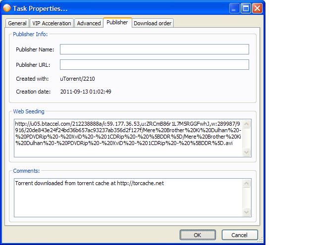

mudit4 Posted September 13, 2011 Author Share Posted September 13, 2011 i enter the http link and keep clicking "OK" bot nothing happens the box do not close here is the link i m entering http://u05.btaccel.com/212238888a/i:59.177.36.53,u:ZRCmB86r1L7M5RGGFwhJ,w:289987/9916/20de843e24f24bd36b657ac93237ab356d2f127f/Mere%20Brother%20Ki%20Dulhan%20-%20PDVDRip%20-%20XviD%20-%201CDRip%20-%20%5BDDR%5D/Mere%20Brother%20Ki%20Dulhan%20-%20PDVDRip%20-%20XviD%20-%201CDRip%20-%20%5BDDR%5D.avi Link to comment Share on other sites More sharing options...

greywizard Posted September 13, 2011 Share Posted September 13, 2011 i enter the http link and keep clicking "OK" bot nothing happens... That is NOT true. You keep clicking OK without paying attention. BC tells you that the URL mush end with a slash sign "/" and that's why it doesn't allow you to close the dialog box. However, as far as I know, that works if you have a URL which contains a copy of the torrent contents (i.e. all the files under the same URL). I've never tested it and I don't know if it works with different URLs for each file. You may try it but you shouldn't expect it to work mandatorily. If it doesn't work you still have the option to download the files just by HTTP. Even if you can't finish the download through HTTP, you can then take the files, and put them all in the folder of the torrent (replacing the ones created by the torrent task) perform a manual hash-check and if the files are identical then you should be able to more or less pick up from where you left. Link to comment Share on other sites More sharing options...

mudit4 Posted September 14, 2011 Author Share Posted September 14, 2011 i mean that the file is in the main folder only. there is no sub folder. I have tried it many times but after pasting the link in the webseeding box i click on OK but nothing happens the box remains open and do not show any error message. Link to comment Share on other sites More sharing options...
