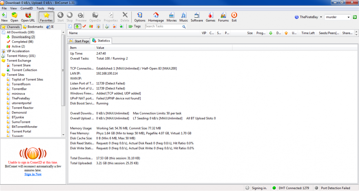

tveiti Posted February 1, 2012 Share Posted February 1, 2012 1) Version 1.31 2) wireles connection 3) Linksys wiresles adapter 2,4 ghz broad band router 4) connected with a rj 45 kabel, but its works whifi as well. Only one router in the house. Have 2 computers they are both connectet to the same router. One with a cable the other with whifi 5) windows 7. AVG 2012.0.1901 6) 7) speed test with speedtest.net download speed 25.94 Mbps Upload speed 2.08 Mbps 8) Bitcomet have been working wery well up til a week ago, now l can not sign in any more, l tog the laptop to another place and it was working very well. when l try to sign in after 24 aclock its working again, but in the morning the same problem, cannot sign in. In the program below the DHT Connected: 1404 is green, but The Port Detecting Failed is grey. Link to comment Share on other sites More sharing options...
kluelos Posted February 1, 2012 Share Posted February 1, 2012 The grey light indicates that BitComet cannot successfully communicate with the test server, to ask it to probe your listen port. That suggests that something is blocking communication. If you are running any blocking software such as peerguardian, this may be what's doing it. Your ISP may be blocking specific addresses. The ability to log in from elsewhere suggests the latter. Logging in to BitComet doesn't actually get you very much, if anything. You will still be able to fully use normal bittorrent connections. For many years I didn't bother to log in at all. Link to comment Share on other sites More sharing options...
tveiti Posted February 2, 2012 Author Share Posted February 2, 2012 Link to comment Share on other sites More sharing options...
tveiti Posted February 2, 2012 Author Share Posted February 2, 2012 l hope my pic. can help. l am not running any blocking softwar on my computer. The program just stop working one day, l did not install any sofware before. :) Link to comment Share on other sites More sharing options...
kluelos Posted February 2, 2012 Share Posted February 2, 2012 Then your ISP is probably blocking the site. As long as you have the gray light, you'll know that BitComet can't communicate with the test server. Link to comment Share on other sites More sharing options...

The UnUsual Suspect Posted February 4, 2012 Share Posted February 4, 2012 You don't need to sign in to use bitcomet, but doing so can help your performance, so it would be good to figure out what is blocking your connection. It would also be good to open your listening port in your router and/or firewall/s so other peers can make connections to you. You're currently blocked, which is why your WAN port has the yellow warning. Basically you have two problems, not just one. Link to comment Share on other sites More sharing options...
