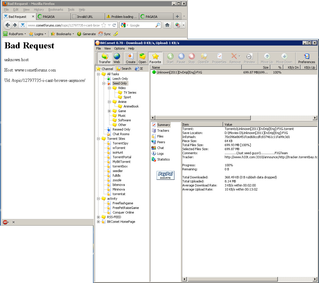

lomayok Posted April 8, 2012 Author Share Posted April 8, 2012 I am having the same problem when I opened bitcomet using the suggested .70 version(please see attached screenshot). I have a bad feeling that this version will crash anytime because everytime I hit the option or anything in it, it hangs for about 1 minute before it respond. This version does not show at the bottom that I am logged in. The one that I used before without the problem shows that I am logged in. What is the first release of version where I can see at the bottom that I am logged in? I think this is where I should start testing what version works for me. If you have anymore suggestions, I am very much willing to try it. Thank you. Link to comment Share on other sites More sharing options...
