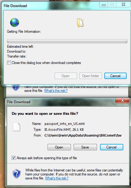

The UnUsual Suspect Posted June 6, 2012 Share Posted June 6, 2012 part of bitcomet's functions require displaying web content, to do this it needs to use a brower and since all windows versions have basic IE support, this is the only option. It doesn't matter what your default browser is, IE will be used. Can you take a screenshot of this error please? Link to comment Share on other sites More sharing options...
tribecaaa Posted June 6, 2012 Author Share Posted June 6, 2012 (edited) Here's the screenshot.... Edited June 6, 2012 by tribecaaa (see edit history) Link to comment Share on other sites More sharing options...
The UnUsual Suspect Posted June 6, 2012 Share Posted June 6, 2012 If I'm not mistaken, this is data to display your rank and points in bitcomet's cometID pane. Normally this data is obtained silently and displayed. I have no idea why your system is treating this as a file download. Try removing the "always ask before opening this type of file" check and click "open". If windows asks for an app to open it with, select bitcomet. This should stop windows from interfering with the process... hopefully. Link to comment Share on other sites More sharing options...

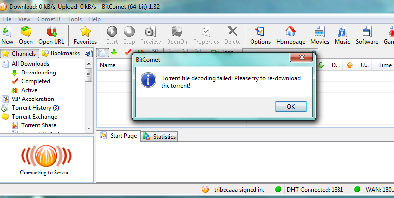

tribecaaa Posted June 6, 2012 Author Share Posted June 6, 2012 (edited) I did as you suggested, changing the association of .MHT to Bitcomet and got the following (see image below). Should I now try to go into the control panel and re-check Internet Explorer? Are there any settings there that can eliminate this? Edited June 6, 2012 by tribecaaa (see edit history) Link to comment Share on other sites More sharing options...
tribecaaa Posted June 6, 2012 Author Share Posted June 6, 2012 After associating the passport MHT extension to Internet Explorer, I re-selected the IE9 feature in my Windows 7. After IE9 came up I selected Bitcomet and the Passport thing did not come up this time. I found two listings in the tools add-ins/extensions with just numbers. I rebooted IE9 and those two listings came back noting Bitcomet and Shanghai Comet. I disabled both, rebooted IE9 and then selected Bitcomet and the MHT thing was gone. I uninstalled IE9 and tried Bitcomet again and no more MHT, gone forever, I hope. Link to comment Share on other sites More sharing options...
