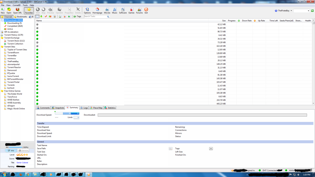

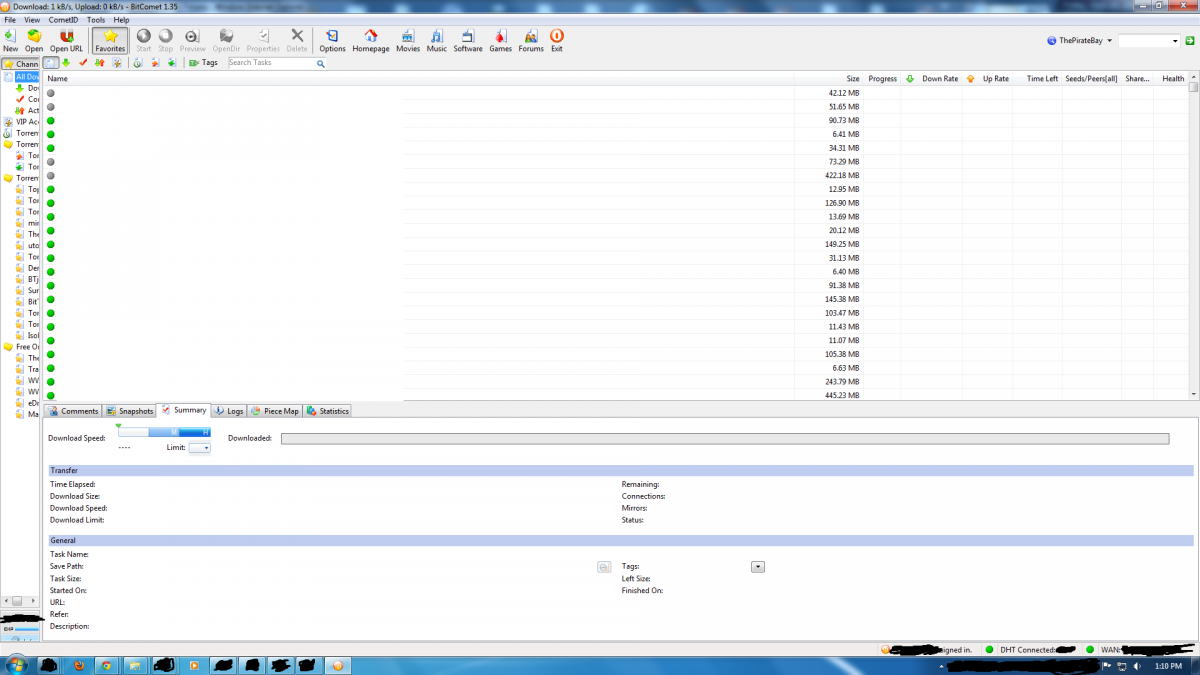

ApexPredator Posted April 26, 2013 Share Posted April 26, 2013 I just recently upgraded to BitComet 1.35 from 1.29. I got a pop-up asking if I wanted to upgrade to this new version yesterday and did so. After it finished installing, the only issue I noticed was that my user interface was really messed up and not adjusted to how I had 1.29 looking. I fixed it up (didn't take too long) and figured that after exiting the program it'd save the user interface height/width adjustments I had made. However, it did not save them and it ended up looking strange again. I have no other upgrade issues (my settings and task/download lists all appear to be fine). I've attached the "How BitComet looks" and "How I want BitComet to look" screenshots so you guys can see what I'm talking about. Of course I've edited the screenshots to hide sensitive information. Also, I did check out the FAQ but I couldn't quite figure out how to associate the task list/pane situation to my user interface one. I also tried to change the system.use_app_data (from true to false) under the advanced tab but it didn't fix the issue. I checked to see if bitcomet.xml was read only and it wasn't. I use Windows 7 Professional Edition. I use a Cable internet connection. I have my ports forwarded and am using a modem and router (not quite sure where to find the model numbers though). Link to comment Share on other sites More sharing options...
The UnUsual Suspect Posted April 26, 2013 Share Posted April 26, 2013 What is your screen resolution setting on your monitor? What happens if you click the "restore down" button in the upper right corner between the (-) and (x) buttons? It looks like something is causing your "name" column in your task list to expand unusually wide and is forcing the entire pane to expand into the area normally used by "favorites" and "cometID". Link to comment Share on other sites More sharing options...
ApexPredator Posted April 26, 2013 Author Share Posted April 26, 2013 (edited) My screen resolution is 1920x1080. Clicking the restore down button makes the program screen size smaller and places it at the left side of my screen, clicking the button again expands the screen back to how it originally looked. The User Interface didn't change in its smaller form either. Could it be that this is a result of very long torrent file names? Because I do indeed have quite a few torrents with very very long names. However, in 1.29 it didn't matter how long the name of the torrent file was and the column didn't adjust to try to display the entire torrent name. In 1.35, even with this User Interface anomaly it can't display the entire torrent name for some of the files because they are just too long. I noticed that when I'm adjusting the User Interface, all the columns are adjusted so that that "Health" doesn't need a scroll bar no matter how much I drag the "favorites" and "cometID" section. It almost appears like the "name" section is expanding as much as it can to display the maximum amount it can of the torrent file names without completely covering up the "favorites" and "cometID" pane. Edited April 26, 2013 by ApexPredator (see edit history) Link to comment Share on other sites More sharing options...
