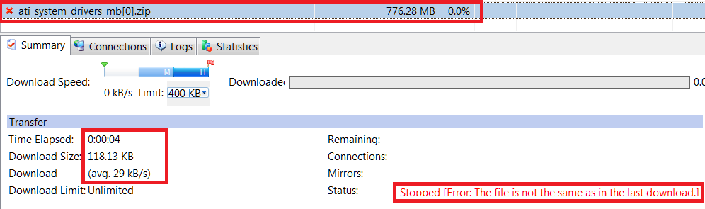

puttachinku Posted May 27, 2013 Share Posted May 27, 2013 OS: wondows 7 profeseional 64bit bitcomet : 1.36 yup that's about it and here is the link if anybody wan't to try it http://download1.msi..._drivers_mb.zip thanks in advance :) Link to comment Share on other sites More sharing options...
puttachinku Posted May 27, 2013 Author Share Posted May 27, 2013 update : I resolved it by disabling 'search for mirror to speed up your downloads' in task properties :) Link to comment Share on other sites More sharing options...
The UnUsual Suspect Posted May 27, 2013 Share Posted May 27, 2013 I'm wondering if the problem was caused by windows adding the "[0]" on the file name. This is done to avoid overwriting existing files. I'll see if I can download this file without the error. Link to comment Share on other sites More sharing options...
The UnUsual Suspect Posted May 27, 2013 Share Posted May 27, 2013 Ok, I figured it out. This host doesn't change the file name when a driver version is updated so when bitcomet looks for mirrors from previous downloads, it finds the files previously downloaded from this exact location is different. Most driver are released with the version number as part of the file name, if this was released this way it wouldn't cause this problem. I think I'm going to consider this a verified bug, although there may not be anything that can be done about it, but at very least we may be able to change the error message to suggest disabling the search for mirrors option. *moved to bug reports* Link to comment Share on other sites More sharing options...
